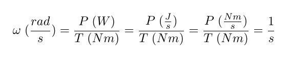

Hi guys,
My first time here. Looks like a nice forum with friendly members.
I have a question. I'm kinda confused by this (and I know it's a shame since I'm on my third year University, almost making my degree).
What I remember from my kinematics/dynamics classes this (or similar) equation always yielded the result in rad/s but now I'm stuck here. I can't justify it using SI units. What I get as output is 1/s which as much as I know is the Hz. Meaning 1 revolution per second and not 1 radian per second.
If anyone could chime in and clarify this for me would be nice.
Thank you in advance.
P.S. My first time here. I didn't know how to insert math equations so I inserted a picture. If this is somehow against the site rules or in the wrong place feel free to remove it or tell me and I'll do it myself.
That's the funny thing about radians. They're not actually units, they're counters, and they're unitless. Sometimes they just come and go as they please, or so it seems. Hz and rad/s are very similar units. If you think about Hz, it's hits/second, or counters/second. Every time your device registers a hit, it adds one and after one second, you have your hz value. If you're talking angular velocity, it's also a counter, it's essentially how many revolutions/second, but using the radius of a circle as the distance between the counters. I suppose the fundamental difference between the two would be that rad/s uses a specific counter, i.e. radians, and Hz is more general. You could readily measure angular velocity in Hz, just pick a spot on the circle, count how many times that your object rotates within the circle, and divide that by the time lapse. That will give you times/second, which, since times isn't actually a unit, it's really 7/second or whatever.
I hope that helped.
Welcome to PF by the way.
There is a lot of (public) confusion here.
The unit, [rad], does not exist as SI-unit. So the unit as for ω is simply [s-1 ]. But people are just writing [ rad/s ] to clarify the meaning. Also Hz has the unit [ s-1 ], but here [ rounds/s ] or [periods/s] is meant. So as for myself I prefer [ rad/s ] = [ s-1 ] and [ Hz ] = [ Hz ]. If all people agreed that, no confusion would exist about this.
So your attached equation is ok: [ rad/s ] = [ 1/s ].

Thank you for the answers.
Now I'm even more confused. Every where is stated that the unit for angle is radia. What exactly do you guys mean with it s not a SI unit?
Hesch, unfortunately i can t just set rad = 1/s because i m facing a problem where these two units(?) yield different results where the rad/sec one seems to be closer to the desired output.

stedwards said:
I think what we are dealing with can be understood in terms of "reduced" vs. "exact" units. My terms. In "reduced units", dimensionless units may be omitted. Note that, units of Hertz replace the older units of cycles/second.
If it confuses problem solving to omit units, include them. There are no hard and fast rules. If the final result must omit radians from the answer, remove them in the last step.
Well, my problem(a small but important part of it) is something like this: I have the power output of a shaft and the torque and need to calculate the angular velocity of this shaft. $$ \omega = \frac{P}{T}$$ Like I said, I know the result's units 'are' rad/s. But I never put too much thought into it until now where I'm trying to design a machine with some gears shafts and an electrical motor (stuyding mechanical engineering by the way) and the units don't fit but must be included when I deliver the paper to my mentor.
The thing is that it kinda looks weird to deal with the units like I did on my question (first post) here and at last, when the result comes out as 1/s, just pull a radian out of my ass and make it rad/s!
NOTE. This is not part of any homework. I need this for a university project.
Thank you for your answers.
ω = P / T →
s-1 = ( J/s ) / (N*m )) = ( J/s ) / J = s-1
The unit [ Nm ] is the unit for torque and for energy.
J = kgm2 / s2
N = kgm / s2

hackYou said:
Yes. Enough philosphy. (lol) You want this.
[tex]\omega [rad/s] = \frac{P[J/s]}{T[J/rad]}[/tex]
Torque is an angular quantity, after all.
Likes hackYou
OK. This makes sense. I could(should) have figured out that much myself. The recent days were certainly not my best.
Thank you.
