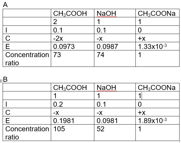

Not sure if its right or not, but after using Ka and an ICE table, I got a concentration ratio of CH3COOH:NaOH:CH3COONa as:
Solution A - 73:74:1
Solution B - 105:52:1
It seems like solution A is the buffer contains around equal concentrations of ethanoic acid and sodium ethanoate at equilibrium, while solution B contains almost twice the concentration of ethanoic acid to sodium ethanoate.

I told you to follow simple stoichiometry and assume reaction went to completion, not to attempt to calculate equilibrium.
(Besides, numbers you posted are definitely wrong.)
