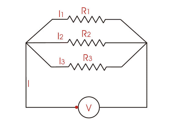

As the title says, i am struggling to understand how if the cell is only supplying 3V how 2 lamps in parallel both receive 3 volts (totalling 6)
I currently study a level physics and never really questioned how this works and just accepted it as the truth.
Can someone explain with a helpful analogy?
thank you
In the standard circuit diagram, each lamp is connected to the battery with a straight lines and there are no other circuit elements between the lamps the battery terminals. Straight lines are equipotentials. Thus the potential has the same value ##V_1## on one side of both lamps and the same value ##V_2## on the other side of both lamps. That means that the lamps are in parallel.
So what youre saying is in parallel both components have the same potential for charge carriers to do work so theyre the same?
I am saying that two conductors in parallel have the same potential difference across their ends.
I think I see now what you mean. Here is the fluid analogy for a circuit. The potential difference across two conductors is analogous to the pressure difference across the constrictions. When you have two constrictions in parallel (bottom drawing taken from the link) the pressure difference between the ends is not additive. Likewise, if the potential difference (think of it as the pressure driving the flow of charge carriers) is not additive. In parallel conductors the currents are additive not the potential differences.
