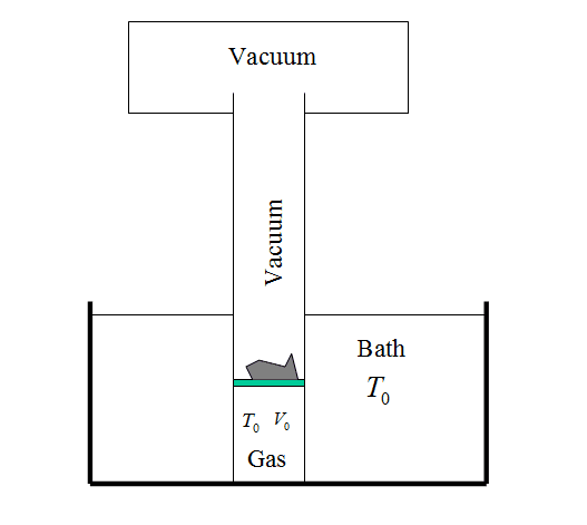

The present analysis assumes that the cylinder is in a vacuum so that external force on the top side of the piston is due only to the weights (gravel or larger weights) on the top of the piston. The piston itself is assumed frictionless, with a cross sectional area of A, and a weight W. The mass of weights on top of the piston in the initial state are w, and, in the final state, these weights have been entirely removed. The gas in the cylinder is an ideal gas (n moles).
INITIAL STATE:
Temperature T
Pressure ##P_1##
Volume ##V_1##
##P_1A=(W+w)##
FINAL STATE:
Temperature T
Pressure ##P_2##
Volume ##V_2##
##P_2A=W##
REVERSIBLE PATH:
For the reversible path, the weights w are removed gradually, so that the system is always close to thermodynamic equilibrium at the constant temperature T. So, for this path, we have: $$\Delta U=0$$and $$Q=Work=\int_{V_1}^{V_2}{PdV}=\int_{V_1}^{V_2}{\frac{nRT}{V}dV}=nRT\ln{(V_2/V_1)}$$But, for an ideal gas, $$\frac{V_2}{V_1}=\frac{P_1}{P_2}=\frac{(W+w)}{W}$$So,$$Q=Work=nRT\ln{\left(\frac{W+w}{W}\right)}$$And the change in entropy of the system is:$$\Delta S=\frac{Q}{T}=nR\ln{\left(\frac{W+w}{W}\right)}$$The change in Gibbs Free energy of the system is then:$$\Delta G=\Delta U+\Delta (PV)-T\Delta S=-nRT\ln{\left(\frac{W+w}{W}\right)}$$The change in entropy of the constant temperature reservoir is -Q/T, so the change in entropy of the system plus the reservoir is zero.
For this reversible change, the granular weights are removed from the piston very gradually as the piston rises, so that some of the weights are removed at the original elevation of the piston, while others are removed at higher elevations, until the piston reaches its final elevation. So the total work done is equal to the increase in potential energy of the piston ##W(V_2-V_1)/A##, plus the increases in potential energy of the particles comprising the weight w, which are distributed over elevations between the original height of the piston and the final height. So the work done by the gas on the piston and weights is significantly more than just that required to raise the piston to its final elevation.
IRREVERSIBLE PATH:
For the irreversible path, the entire weight of granules w is removed suddenly from the piston at time zero. As a result of this, the piston spontaneously accelerates upward because of the unbalanced net force caused by the removal of the granule weights; and the piston even overshoots its final equilibrium elevation. But eventually, because of viscous damping by the gas within the cylinder, the oscillations of the piston about the final equilibrium elevation decrease, and the piston ultimately comes to rest at its new elevation. In this case, the potential energy of the granules that were removed at the initial elevation of the piston do not change; only the potential energy of the piston itself changes. So, in the irreversible case, the amount of work done by the gas is less than in the reversible case, and is given by: $$Work=W(V_2-V_1)/A=P_2(V_2-V_1)=P_2V_2(1-V_1/V_2)=nRT(1-P_2/P_1)=nRT\left(1-\frac{W}{W+w}\right)=nRT\left(\frac{w}{W+w}\right)$$In order for the work to be less, the average force of the gas on the piston (averaged over the displacement variations of the piston) must be less than in the reversible case. This lower average force is made possible by viscous stresses in the gas which act in the direction opposite to the movement of the piston.
Since the change in internal energy ##\Delta U## between the initial and final equilibrium states of the gas is again zero, the heat added from the reservoir is equal to the work done by the gas on the piston:$$Q=Work=nRT\left(\frac{w}{W+w}\right)$$So, in the irreversible case, the expanding gas does less work on its surroundings (the piston) and the amount of heat absorbed by the gas from the reservoir is also less.
In the irreversible case, since the reservoir is ideal, its change in entropy is ##-Q/T=-nR\left(\frac{w}{W+w}\right)##. So, in the irreversible case, since the change in entropy of the system is unchanged, the change in entropy of the system plus surroundings is > 0. This is the result of entropy generation within the system as a result of viscous dissipation of mechanical energy.
SUMMARY:
So you can see that, even without friction, the irreversible gas expansion does less work on the surroundings than in the reversible case, and the amount of heat transferred from the reservoir to the gas is also less. For more discussion of how viscous dissipation contributes to reducing the amount of expansion work that a gas can do in an irreversible process, see my Physics Forums Insights article in https://www.physicsforums.com/insights/reversible-vs-irreversible-gas-compressionexpansion-work/

I am not comfortable with the term irreversible. When do you call a process irreversible?
Consider an ideal gas in a container with a massless, frictionless piston with some big rocks kept above it. Let the system be in contact with an ideal reservoir of temperature T. Now I remove some rocks above the piston and the gas rapidly expands due to the drop in pressure. Then I place the rocks back on the piston and thus the original pressure is restored. Since the temperature remained constant, the gas must compress and return to its original state with the same initial P,V and T. So, haven't I conducted a reversible process?
(I know this process mentioned above is irreversible because it has not been done quasistatically but I want to know the exact point to what led me to irreversibility during this process)

These are excellent questions.
Let me start out by defining an Internally Reversible Process. An internally reversible process is one for which your system passes through a continuous sequence of thermodynamic equilibrium states. Such a process is, of course, quasistatic. The process you described above is not internally reversible. For it to be internally reversible, you would have to decrease the load of rocks (granules) very gradually, with each individual granule having infinitesimal mass.
A Fully Reversible Process is one in which both the system and the surroundings (treated as a separate system) undergo matching internally reversible processes. In such a process, both the system and the surroundings can be returned to their original states (by following the reverse path) without significantly affecting anything else (either thermally or mechanically) in the universe.
An alternate test for an internally reversible process is if ##\Delta S## for the system is equal than the integral of ##dq/T_B##, where ##T_B## is the temperature at the boundary between the system and the surroundings during the process. If it is greater than the integral, then the process is irreversible. This is the Clausius inequality.
An alternate test for a Fully Reversible Process is to determine the sum of the entropy changes for the system and the surroundings. If it is zero, then the process is Fully Reversible. If it is greater than zero, then the process is not Fully Reversible. If it is negative, then you made a mistake.

A reversible process represents the limiting behavior of real processes. It tells us the maximum amount of work that can be done and the maximum amount of heat that can be transferred, or the maximum temperature change to expect. It is also important in chemical thermodynamics, for deriving equations for the equilibrium constants for chemical reactions.
How is the process of removing one big rock different from removing infinitesimal granules at a time? What difference does it make?
The amount of work will be different. The equation for the work is ##W=\int{P_{ext}dV}## where ##P_{ext}## is the force exerted by the piston on the gas at the piston face. In big rock situation, ##P_{ext}## will drop to a lower value suddenly, while in the infinitesimal granules case, ##P_{ext}## will decrease gradually with V.
Could you give an example of how you would conduct a fully reversible process?
If I wanted to do a fully adiabatic reversible expansion of a gas, I would have the granules sitting on top of a piston, and, as I removed them (say by pushing each of them, in turn, horizontally sideways), I would slide them onto shelves at the elevations they had when they left the piston. Then, for the reverse path, I would add one new infinitesimal granule at the top to get things started, and then gradually slide them off their shelves onto the piston at their various elevations until the piston was at its original elevation again. In the end, the granules, the piston, and the gas would be in the exact same state at which they started (except for the infinitesimal granule added at the top, and the additional infinitesimal granule remaining on the piston when it reached its bottom location again).

I have a vertical cylinder with an ideal gas inside of volume ##V_0## and temperature ##T_0##. The bottom half of the cylinder is sitting in a constant temperature bath, also at ##T_0##; the top half of the cylinder is insulated. There is a frictionless piston of mass m sitting on top of the gas, and a pile of rock granules of mass M sitting on top of the piston. The top of the cylinder connects to a vacuum chamber, so that the top of the piston, the rock, and the part of the cylinder above the piston are all exposed to a perfect vacuum at all times.
Does this description of the physical system make sense to you so far?
I will be posing questions to you along the way that require you to do some analysis to come up with the answers. In this way, we will work our way through to the end.
View attachment 203290Does this description of the physical system make sense to you so far?
Nice Question!
I have a silly question though. Is this situation possible in the real world? (maybe close to this)
If not why do we think of such hypothetical situation?
Other than this, it made good sense to me. You can proceed to ask questions.
DoubtExpert said:
Nice Question!
Situations like this do occur in the real world, but, of course, there are additional complexities. When you are trying to learn something new, you start out simple, and then build on your knowledge. You don't go to the most complex problem from the outset, and then find that you get nowhere with it. I still need to see some demonstration on your part that you have mastered even the simple concepts. So, regarding our problem, here are some questions:
If the system in the figure is in thermodynamic equilibrium to begin with, what is the force F that the gas is exerting on the lower face of the piston (in terms of m and M)?
If the area of the piston is A, what is the pressure that the gas is exerting on the lower face of the piston?
What is the number of moles of gas in the cylinder?
We are first considering the situation where, at time zero, the pile of granules is suddenly removed from the top of the piston, and the gas experiences a rapid spontaneous expansion, at the end of which the system attains a new (final) thermodynamic equilibrium state.
In the final thermodynamic equilibrium state, what is the the force F that the gas is exerting on the lower face of the piston (in terms of m and M)?
What is pressure that the gas is exerting on the lower face of the piston?
What is the volume of the gas at the end of the expansion?
For the period of time during the expansion, if F(t) represents the force that the gas is exerting on the lower face of the piston at time t, write down a Newton's second law force balance for the motion of the piston.
$$Force\;({F_0}) = \left( {M + m} \right)g$$
$$Pressure\;({P_0}) = {{\left( {M + m} \right)g} \over A}$$
$$No\;of{\kern 1pt} Moles\;(n) = {{\left( {M + m} \right)g{V_0}} \over {AR{T_0}}}$$
$$Force\;({F_1}) = mg$$
$$Pressure\;({P_1}) = {{mg} \over A}$$
$$Final\;Volume\;({V_1}) = \left( {{{M + m} \over m}} \right){V_0}$$
Let ##a(t)## represent the ##acceleration## of the piston at time ##t##. Then,$$\eqalign{
& F(t) - mg = ma(t) \cr
& F(t) = m(g + a(t)) \cr} $$
