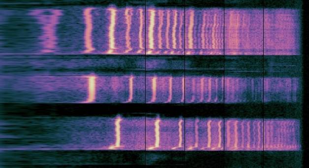

I thought that as well but have proven that wrong by recording a spectrogram. If the growl were just a beat frequency, it wouldn't show up on the spectrogram but it does..
If the growl comes from the saxophone, it involves the non-linearity of the reed, so energy can then appear at the beat frequency and the harmonics of that.

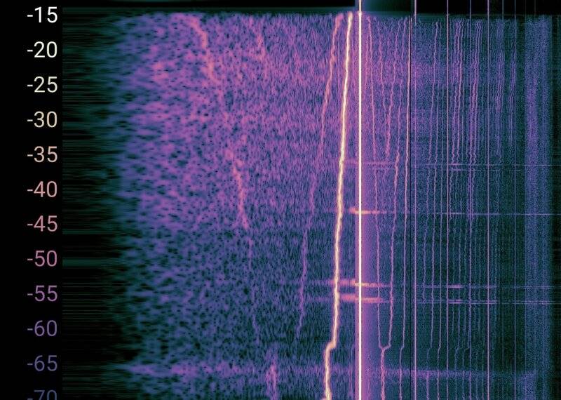

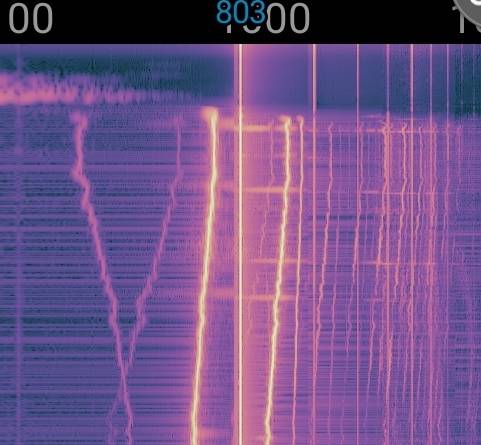

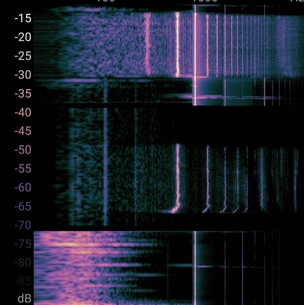

Anyways, I found out that the whole resonator tube doesn't matter. I did it with just a mouthpiece and yeah it works.
The bottom spectrum comes from the mouthpiece (around 800Hz but not important), the one in the middle is my voice (falsetto obviously) and finally both combined. The subharmonic is still there. At this point it can't be called a growl, sounds more like a dying guinea-pig.

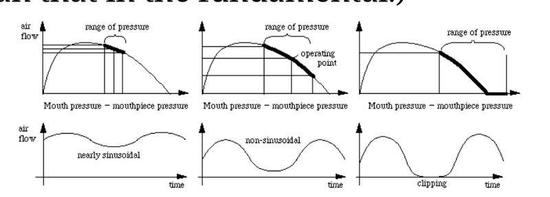

I came across the air flow vs pressure difference (between mouthpiece and mouth cavity) function of the clarinet and it's nonlinear in itself, something like:
## Flow(\Delta p) \propto (1-\Delta p) \sqrt{\Delta p}##
The peak of the plot is the threshold for playing. So in the end, you play at some operating point and yeah large oscillations around that point will be nonlinear. So in the end, I think Berkeman was right. The thing is I can never play quietly enough to produce a single sinusoid

Yes, I can say with certainty that it's a difference frequency. To address your worry about the voice having too many harmonics: It doesn't necessarily have to. Like written above, singing quietly and in falsetto leads to almost a sine wave.
I put my phone near my mouth and played a tone at, say 800 Hz, while singin. If you ask me, everyone has a phone and everyone has vocal chords, so this as easy to replicate as it gets and you can feel free to do it if you doubt the results (if no one is around xD). Note that the scale is logarithmic, so the harmonics are not nearly as strong as they appear to be, but yeah it's hard to get rid of the first harmonic in the falsetto.
from bottom up: sine at 800Hz; falsetto voice at 800Hz/1.5; both
To prove that this is indeed a difference frequency, I simply increased the pitch of my voice and, as you would expect, as the fundamental frequency of my voice got closer to 800Hz, the difference frequency dropped. And you see another difference frequency that increases, as the first harmonic of my voice gets further away from 800Hz.
