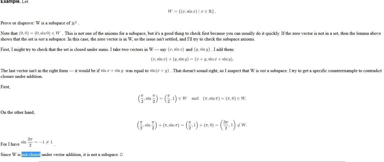

What exactly does it mean for something to be closed under addition.
most of the examples and questions i have gone past, are answered with
u + v = u1+v1, ... , u_n + v_n and hence this is closed under addition.
So i tried looking for examples where something was not closed under addition, and I found this [refer to attached image]
I follow everything up until the second last and last line;
"For I have sin(3pi/2) = - 1 $\neq$ 1
what does it matter that sin(3pi/2) doesn't = 1?
Would anyone be able to explain what is going over my head? It seems like such a basic concep that I am not understanding.

Hi nacho!
Let me give it a shot to try and clarify.
We want to know if $(3\pi/2, 1)$ is an element of W.
For it to be the case, it must be of the form $(u, \sin u)$.
So $u = 3\pi/2$ and $\sin u = 1$.
If we substitute the first in the second, we get:
$$\sin 3\pi/2 = 1$$
But this is not true.
Therefore $(3\pi/2, 1)$ is not an element of W.
So we have found a counter example where the sum of 2 elements in W is not an element of W.
For a set to be "closed" under an operation (such as addition or multiplication), it means that whenever you add two numbers in that set, you will always get another number that belongs to that set.
For example, the set of all real numbers is closed under addition, because when you add any two real numbers you always get a real number.
As another example, the set of all odd integers is NOT closed under addition, because when you add two odd numbers you get an EVEN number, something not in that set.
Here is an often-used example:
Suppose $S \subseteq \Bbb R^2 = \{(x,0): x\in \Bbb R\} \cup \{(0,y): y \in \Bbb R\}$
(that is to say the $x$-axis and the $y$-axis together).
Now, it is clear that two points on the $x$-axis added together still lie on the $x$-axis:
$(x_1,0) + (x_2,0) = (x_1+x_2,0)$, and similarly for the $y$-axis.
But if we add a point on the $x$-axis, to a point on the $y$-axis, say for example:
(2,0) + (0,3) = (2,3)
it is clear that this point does not lie on EITHER axis (unless both points are the origin, a special case).
In general, we are often given a SUBSET of a vector space, and we want to know if it includes all possible (finite) linear combinations of elements in the set. Put another way, we want to know if the addition operation of some vector space $V$, "stays within $S$", so that addition is an operation on $S$ in its own right. And this means:
IF $u \in S$, AND $v \in S$, THEN $u+v \in S$ also.
Subsets that do not obey this are said to be "not closed under addition".

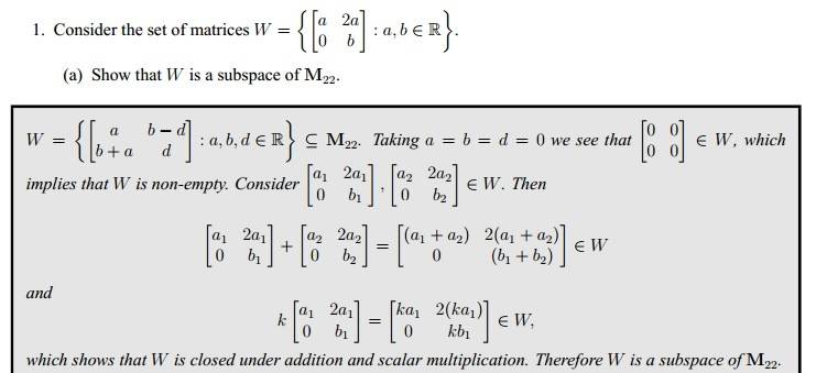

Hi thanks for the responses everyone, I seem to have had a similar conceptual understanding, but would like to see it applied in a more general sense.
I have attached an example of what I mean.
How is it conclusive from the third and fourth line that the set W is closed under addition and multiplication?
I mean, all they've done is added them up and multiplied by scalar k. But can't you do that with any general set, and then turn around and say it is closed under scalar multiplication and addition?

First off, your example contains a mistake.
As the first step a definition is "repeated" for W.
But that is not the W from the problem statement, nor are the remaining steps applicable to it.
Confusing! (Doh)
Anyway, the point is that for any 2 elements of W the addition is an element of W.
So we pick 2 element with symbols that can still represent any element of W.
Then we add them and verify that the result matches the definition of an element in W.
It must then be true that the addition of any 2 elements from W yield indeed an element in W.
Similarly we multiply a representation of any element of W, with a scalar that can be any scalar. And again we verify that the result matches the definition of an element in W.
That makes it closed for addition and scalar multiplication.

nacho said:
Not exactly sure what you mean here?
Look again at your problem statement and how its resolution starts? (Thinking)
Ah I see what you mean, just glossed over that.
Also thanks deveno, somehow I must have not noticed your previous post but that makes sense now! :)
