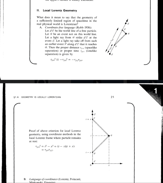

A Why is Tau-AB^2 not t^2 + x^2?
BLevine1985
TL;DR Summary
question about proof page 21
why is Tau-AB^2 equal to t^2 - x^2 ?It seems it should be t^2 + x^2 according to the geometry of the diagram...
Because that's how the metric is defined in an inertial frame in special relativity.
No, because the diagram is not depicting a Euclidean geometry. It's depicting a Minkowskian geoemetry. That means you cannot interpret lines and angles in the diagram as if they were Euclidean; they aren't.

Thank you. That was very helpful!
