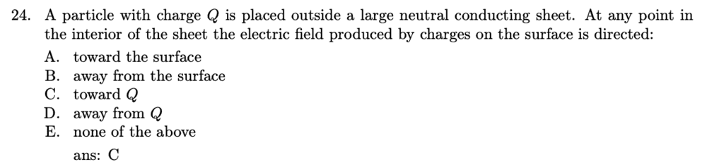

A particle with charge Q is placed outside a large neutral conducting sheet. At any point in the interior of the sheet, the electric field produced by charges on the surface is directed:
A. toward the surface
B. away from the surface
C. toward Q
D. away from Q
E. none of the above
(Conceptual)
The answer according to the key is C. I thought the answer would be E since the electric field inside a conductor is always zero. Can someone explain why the answer is C?

The net electric field at a point P inside the conductor will be zero. But, the field due to the charge on the surface of the sheet will not be zero at P.

Ah, I see. How do we get an indication of the direction of the field if we are not given the sign of charge Q?
Good question. Without knowing the sign of Q there is not a definite answer to the question.
If I had to make a choice, I would assume Q is positive.
Likes PhDeezNutz
Criminal. The correct answers for both signs are among the multiple choice answers. Getting a correct answer should not depend on you reading the professor’s mind correctly. Complain vociferously and don’t let him/her weasel out with some lame excuse like “Well, obviously if I don’t state the sign it’s positive.”
