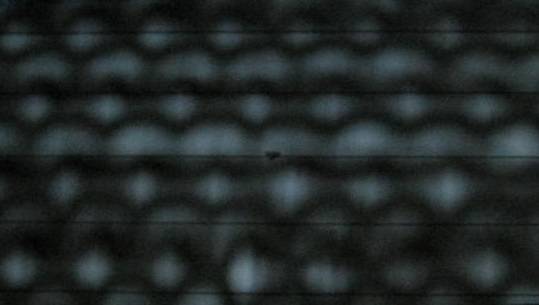

When looking through polarizing glasses at the rear window of a car (tempered glass), a black and white pattern appears. Supposedly, this is the same kind of birefringence that causes colored fringes in a plastic sheet, seen through a polarizer. It is clear that retardation and interference in the plastic sheet results in colored fringes. What is so different about the rear window of a car that prevents the colors?
Lcd display seen through rear window and polarizer
Offhand, I would say it's because sunlight has a broad spectrum- the colors are 'smeared' out.
For comparison, a photo of a birefrigent cd case, seen through the same polarizer, and looking at the same polarized lightsource (an lcd display) in the background. Color appears because birefringence means retardation. Why is a birefringent rear window different?

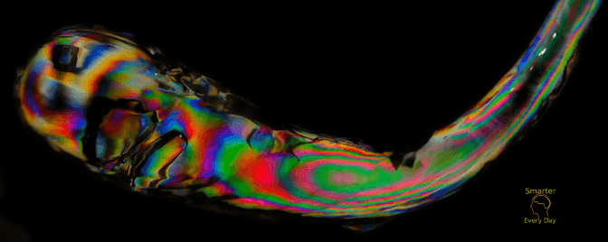

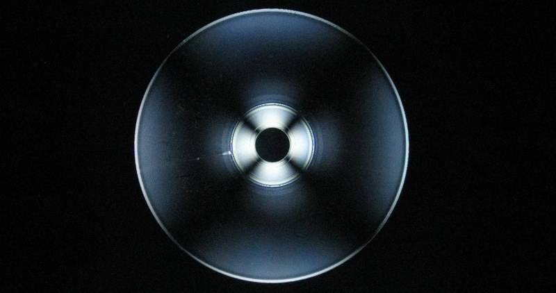

The old prototype of tempered glass, Prince Rupert's drop (click), apparently induces colors between crossed polarizers. Maybe tempered glass has a black and white or 'zebraic' extinction pattern if the thickness of the glass is about λ n/Δn, and do colors appear at greater thickness. I also noticed that polycarbonate cd disks induce a black and white 'Maltese' cross which is typical for uniaxial birefringent materials. Maybe somehow that's another explanation.
Rupert's drop between crossed polarizers; image from the video by Smarter Every Day at 3m20s
Clear substrate cd disk between crossed polarizers: Maltese cross

If the sample is rotated 90 degrees does the light-dark areas change?
You might have to rotate the LCD screen and polarizer to get the rotation wrt the sample correctly done.
With the colored sample, rotate that one and the colored areas should change.

One possibility is shown on the Michel-Levy chart: ... The color saturation is very low for low amounts (less than 1/4 wave) of retardation.
I agree that the absence of colors means that the retardation is less than 1/4 λ.

90° rotation of the crossed polarizers (together) results in an identical black and white pattern.
256bits said:
The usual explanation for the back window for reflected light is that the window changes the light to horizontal which your polarized sunglasses block out. The spotted areas reflect vertical light which your sunglasses do not block. Not frequency dependent it seems.
Reflected light is slightly more complicated than transmitted light. For transmitted light, the black lines are the areas where the rear window does not change the polarization direction of the incoming light. The extinction is caused by the crossed polarizers.
Apparently the black curvy lines are the so called isogyres. When rotating the crossed polarizers over 90° (together), it would turn out that each point of the window has its own polarizer angle α between 0° and 90° that makes it black. That is the privileged direction in that point. The perpendicular direction is privileged as well. The pair of privileged directions could be marked by drawing a small cross in each point of the window. By connecting the crosses the pair of privileged directions could be visualised as two lines systems on the window.
The two privileged directions are actually the slow polarization direction and the fast polarization direction in each point of the window. If the crossed polarizer direction is parallel to either, the extinction will be maintained, and that point will be black.
