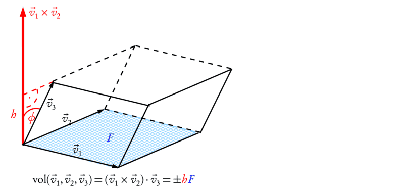

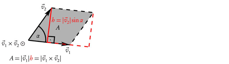

The vector product in ##\mathbb{E}^3## has two quite intuitive geometrical meanings.
(a) it measures oriented areas
If you have two linearly independent vectors ##\vec{a}## and ##\vec{b}## by definition ##\vec{a} \times \vec{b}## is a vector perpendicular to the plane spanned by the two vectors (with the direction chosen according to the right-hand rule) with the magnitude given by the area of the parallelogram spanned by the two vectors.
It turns out that the operation is linear in both arguments and that it's antisymmetric, i.e., ##\vec{b} \times \vec{a}=-\vec{a} \times \vec{b}##.
(b) it describes "infinitesimal rotations"
If you have a rotation matrix ##\hat{D}_{\vec{n}}(\alpha)##, which describes a rotation by an angle ##\alpha## along an axis defined by the unit vector ##\vec{n}## (with the sense of the rotation according to the right-hand rule), then for small ##\alpha##
$$\hat{D}_{\vec{n}}(\alpha) \vec{V}=\vec{V} + \alpha \vec{n} \times \vec{V} + \mathcal{O}(\alpha^2).$$

The magnitude is, according to meaning (a)
$$|\vec{a} \times \vec{b}|=|\vec{a}| |\vec{b}| \sin \angle(\vec{a},\vec{b}),$$
where ##\angle \vec{a},\vec{b} \in [0,\pi]##.

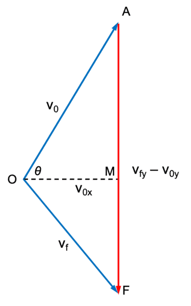

So, yes, it is useful. But how did they know in advance (when constructing this operation) that it would be useful?
I don't know about "them" but I can tell you from my own experience how I happened to come upon the range equation on my own before reading Winans's article. I started by considering the development of an alternate method for solving projectile motion problems using geometry and trigonometry instead of quadratic equations. That work is described here. I used what I call 'the velocity triangle" consisting of the initial and final velocity vectors. Then I considered how one can use the triangle to find what one usually finds in projectile problems, the horizontal range included.
I did not know in advance that the range can be written as the magnitude of a cross product divided by
##g## but I knew that half of the magnitude of the cross product is the area of the triangle having as sides the two vectors. Looking at the velocity triangle (see figure on the right), it became obvious to me that the range ##R=v_{0x}~t_{\!f}## where ##t_{\!f}=\dfrac{v_{fy}-v_{0y}}{g}## is the area is the area of the triangle divided by ##g##. Putting the two thoughts together gave me the cross product equation for the horizontal range. Just to make sure, I verified that ##|\mathbf{v}_f\times\mathbf{v}_y|=|v_{0x}(v_{fy}-v_{0y})|.##
To make a long story short, I didn't start out intending to find use for the cross product. I stumbled onto it by diddling with the velocity triangle in order to find an alternate description for projectile motion. As we say in the profession, if we knew what we are doing, it wouldn't be called research.

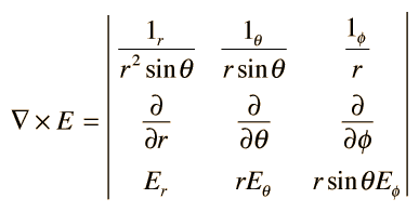

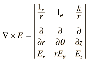

From the point of view of one of the possible algorithms for carrying out the operation (there may be others, I don't know), it has the structure of a calculation of the determinant of a 3x3 matrix. However, the matrix elements of the second and third rows are coordinates, while the matrix elements of the first row are unit vectors. This strange lack of parallelism in this operation leads me to classify this product as a rather unique operation.
I regard this as an abuse of notation. It is used because it happens to give the correct result, not because it makes mathematical sense.
In the same way, the curl can be computed in cartesian coordinates by means of a determinant in which the first row are unit vectors, the second are differential operators, and the third are functions. This does not give the correct answer in curvilinear coordinates.
They work, but the first rows aren't unit vectors.
In my copy from Dover, of the 1891 third edition of Maxwell's Electricity and Magnetism, published of course after he had died, and proofed by Thomson, the "preliminary" discussion of mathematical theorems, including what we call Stokes's theorem, uses quaternions. In particular, the operator "del" defined as i∂/∂x + j∂/∂y + k∂/∂z, is manipulated (bottom p.29) by "remembering the rules for multiplication of i,j,k". In particular, on the last page, p.30, the formula del^2 = minus the Laplace operator, depends on the rules i^2 = j^2 = k^2 = -1, ij =k, ji = -k, etc... as does the fact that the usual divergence appears there with a minus sign and called therefore the "convergence".
I do not know how these formulas appear in earlier editions. And what I am calling "del" seems to be "nabla" or "inverted delta".
