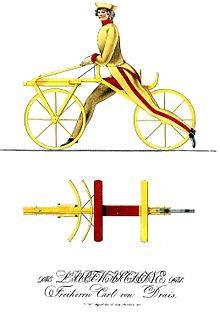

Ah, a symmetrically balanced scooter with large diameter wheels. I could not figure it out (from the picture), until I noticed the support "harness."
The early bikes were all like that...
http://en.wikipedia.org/wiki/History_of_the_bicycle
The first verifiable claim for a practically used bicycle belongs to German Baron Karl von Drais, a civil servant to the Grand Duke of Baden in Germany. Drais invented his Laufmaschine (German for "running machine") of 1817 that was called Draisine (English) or draisienne (French) by the press..
