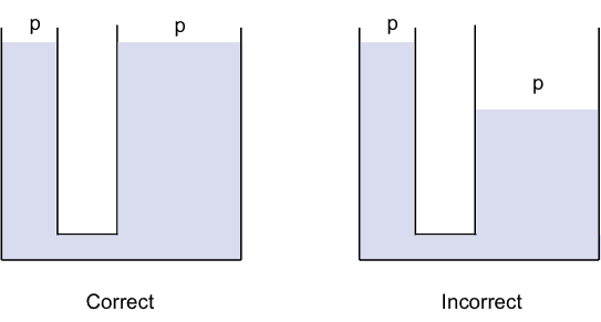

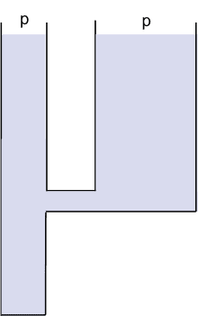

i am talking about this :
and this ( this is just an example of what i am saying btw)
what does he mean by that ? if we use u shaped tube with two branches with different diameters realistically we should get totally difference results as the branche with smaller diameter will increase the height of the liquid. i just need a clarification of what the textbook is saying
i know my question might look so lame but i am not a physicist.

There is no requirement that each side have and equal volume of liquid.
The pressure at a given depth ##d## is the weight of the fluid above that depth divided by the cross-sectional area of the tube, ##p=\frac{mg}{A}.##
The mass above that depth is equal to the density of the fluid multiplied by the volume ##m=\rho V.##
The volume is the height (same as the depth) of the column times the area, ##V=Ad##.
Putting it all together$$p=\frac{mg}{A}=\frac{\rho~ A~ d~g}{A}=\rho~g~d$$Note that the area cancels out therefore the two sides can have different cross-sectional areas yet the pressure will be the same at the same height on each side.
In the figure you posted the pressure is the same at points A and B. The reason the column of fluid is higher above point B is that oil is less dense and therefore the pressure does not vary as rapidly with depth as in water. To get the same pressure as at A you need a higher column of fluid above B.

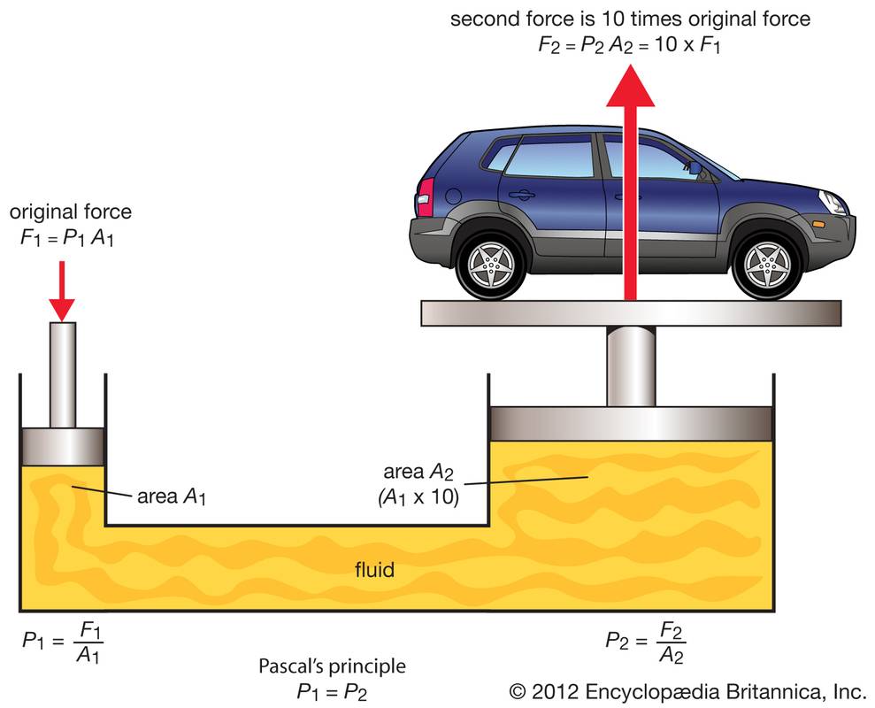

Here's another illustration of the same principle in action, from https://www.britannica.com/science/Pascals-principle:
llustration of Pascal's principle at work in a hydraulic press. According to Pascal's principle, the original pressure (P1) exerted on the small piston (A1) will produce an equal pressure (P2) on the large piston (A2). However, because A2 has 10 times the area of A1, it will produce a force (F2) that is 10 times greater than the original force (F1). Through Pascal's principle, a relatively small force exerted on a hydraulic press can be magnified to the point where it will lift a car.
Encyclopædia Britannica, Inc.

I am not sure OP was asking about Pascal's principle. I think OP was asking why the picture on the left is correct and the one on the right is incorrect.

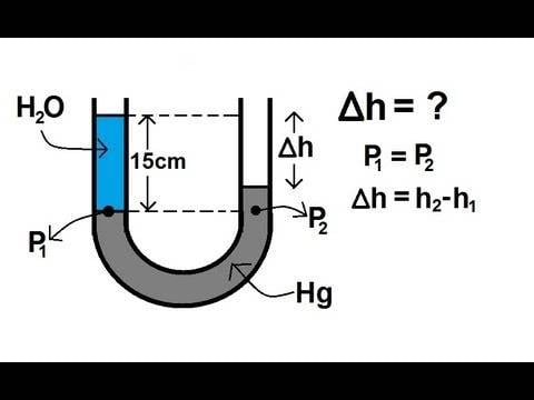

It's a pretty good, reasonably on-topic (I think) video, so I'll leave it linked as a video, but I'll also go ahead and synopsize the diagram:
That diagram depicts water, which is of density (as specific gravity) 1, in one end of the tube, and mercury, of density about 13.6, in the other end. With both ends of the tube open to the atmosphere, the water end will be visibly higher above the equal pressure line in the tube, for equal weights of water and mercury above that line, the zero line.
In the diagram, the label says P1 = P2, which makes the line between them horizontal, and makes that line the zero line.
The zero line is set at the lower of the 2 mercury levels, because there's only mercury below that level, therefore only one fluid density, so the heights at that level being the same, the pressures are the same, just as we see equal liquid height in a U-shaped tube when there's only 1 liquid and both ends are open to the atmosphere.
If the water height above P1 is 15 cm, then the mercury height above P2 should be about 1/13.6th of that, or about 1.1 cm (the diagram's not drawn to scale), because mercury is 13.6 times as dense as water. The video explains that calculation in detail. (If instead of using mercury for a barometer you made a water barometer, then instead of atmospheric pressure being about 76.6 cm of Hg, you'd have about 10.4 m. of H2O.) The diagram poses the question what is ##\Delta h## equal to (I'd have called it h1-h2, instead of h2-h1, as on the diagram label); it is the (absolute) difference between the heights above zero of the water and the mercury, meaning 15 cm - 1.1 cm, which is 13.9 cm.

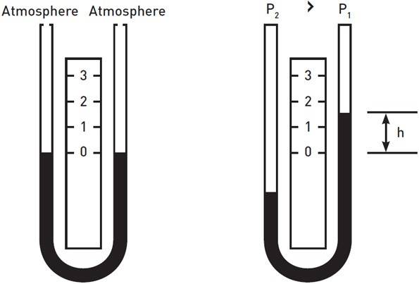

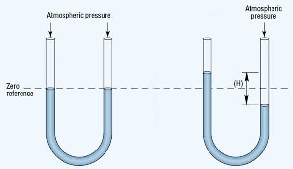

For a single fluid of uniform density, as in the 2 diagrams of pairs of tubes below, you get different heights at the 2 ends of the tube only if there's a difference between the pressures at the 2 ends.
Please note the difference between the use of the term h in the 1st image vs (H) in the second image.
In second of the pair of tubes in that image, P2 > P1, and h refers to how far above the zero line the fluid at the lower-pressure end is.
In that image, (H) refers to how far zero is above the lower fluid level, plus how far the higher level is above zero.
