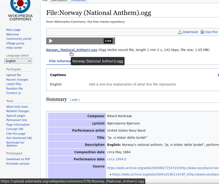

This is where the link to the audio file is (at the mouse pointer):
Likes jedishrfu and Greg Bernhardt
Yes, but the OP will still need to have some app available to play the audio file.

jack action said:
Those files ("/wiki/File:[filename]") are HTML files about a particular file named [filename]. You can check with your favorite browser by selecting "View page source". The extension in [filename] is misleading: there are no extensions for the files in the wiki/ "directory" of Wikipedia.
Sure. That's why the first two I tried didn't work.
My code works with the third file because it doesn't have the File: bit in the filename . :wink:
