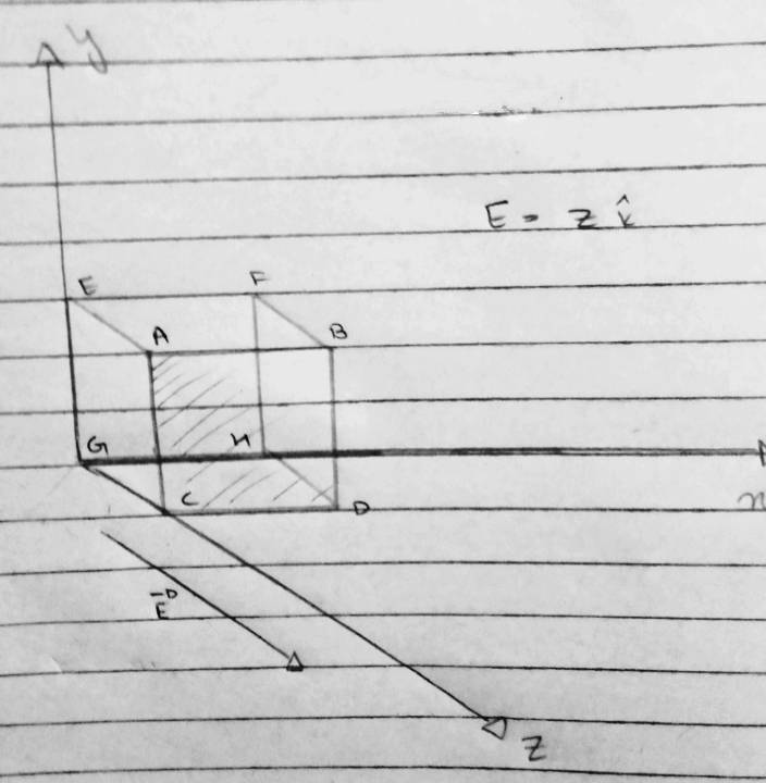

Suppose we have placed a cube in field which varies linearly with z axis so electric field magnitude on coordinates of face ABCD is clearly more than face EFGH and we know area of both faces are equal,
So if we calculate flux then it would be non zero but it contradicts with the fact that electric field through closed surface enclosing no charge is 0.
Please tell me where I am wrong.
You have posited a field which requires that a particular charge distribution exists. And then you posited a different charge distribution.
The fact you’re talking about is applicable only to certain surfaces. You can have a contradiction like this also, consider a surface whose end sides are not parallel but equal in magnitude, and if you place this closed surface in a uniform electric field the net flux will not be zero.
Your charge density is, according to Gauss's Law
$$\rho=\epsilon_0 \vec{\nabla} \cdot \vec{E}=\rho_0=\text{const}.$$
As @jbriggs444 says (edit: and @vanhees71), your cube encloses charge. Your electric field is ##\vec E=kz\vec{\hat{z}}##, where ##k## is a constant, so ##\nabla\cdot\vec E=k##, which Maxwell's equations tells you is the charge density - clearly non-zero.

I got its answer,
Its net flux would be non-zero because this situation is hypothetical as we cannot draw it's field lines because if we diverge or converge(so as to show its magnitude)then its field E would be in y or x direction which Is not possible according to situation,but in real situation electric flux would always be 0 as no. Of field lines entering are always equal to field lines leaving.

No! The electric field has a source, electric charges. That's described by Gauß's Law for the electric field. In its fundamental form its written as one of the inhomogeneous local Maxwell equations (in SI units),
$$\vec{\nabla} \cdot \vec{E}=\frac{1}{\epsilon_0} \rho.$$
Using Gauß's integral theorem you can integrate this of a volume ##V## with boundary ##\partial V##, leading to
$$\int_{\partial V} \mathrm{d}^2 \vec{f} \cdot \vec{E}=\frac{1}{\epsilon_0} \int_{V} \mathrm{d}^3 r \rho=\frac{Q_V}{\epsilon_0}.$$
So if there is charge inside the volume the flux of the electric field through its surface is not 0 but proportional to the total charged contained within the volume.
In a situation where the laws of classical electromagnetism hold, the flux enclosed by a closed surface is zero only if the closed surface does not contain any charge. If the closed surface contains charge, the flux enclosed by the surface can be non-zero.

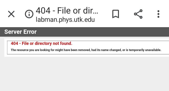

This link is not working
Very strange! (Sorry about that.)
I'll try to cut and paste the section, see if it works:

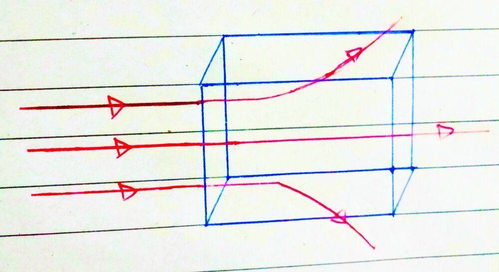

But their is one another thing which i can't understand.
In the figure I have posted if we try to find flux using formula then we can clearly see that flux of electric field lines leaving is less than that of entering field lines as field lines which are leaving are at some angle(so no.of field lines penterating perpendicularly are less).
We can see that net flux is 0 as no. Of field lines entering are equal to leaving but if we try to find it using formula it seems to me that it should be non-zero.
Your diagram only has three field lines so it's unclear what you are trying to show. If there is no charge in the closed volume, the net flux will be zero. To use the formula you'll need the electric field values.
You shouldn't take "field lines" too literally. They're integral curves of the field, but that means there are infinitely many of them - one passing through every one of the infinite number of points on each side. If you draw a great many of the lines you can count the number passing through each side (dotted with the vector area of the part of the side they pass through, as you note) - but this is just using a sum as an approximation to an integral. That is, ##\sum_{i=1}^n \vec{E}_i\cdot\delta\vec{A}_i\approx\int\vec E\cdot d\vec A## if the number of elements, ##n##, in the sum is large. That certainly won't work if you only draw three field lines, though, because the sum is an extremely poor approximation to the integral.
Do you think the number of lines per square meter entering must match the number of lines per square meter leaving? No, that is incorrect. Strike out the "per square meter" phrases and it becomes correct.
As @anorlunda notes, the number of field lines corresponds to flux itself, not to flux density. Same number of field lines means same flux. Distributing them over a greater area (by spreading them out radially or changing to angle to the surface) represents a reduction flux density.
I agree but a very intuitive explanation, which involves field lines goes: How could a situation exist where the number of field lines entering an region is less then the field lines leaving it? There would have to be a 'source' of field lines inside (new lines would need 'ends' on them). In electrostatics, the only source I can think of is a Charge. This is independent of the uniformity or otherwise of flux density.
Next step in this is to believe what the integrals tell you.
