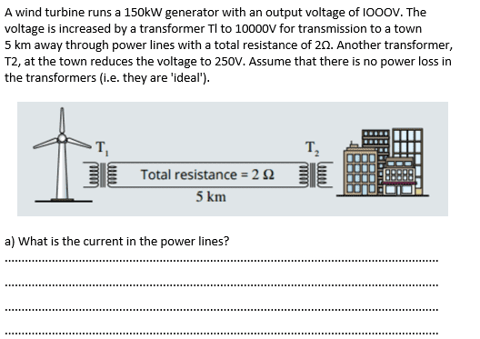

Thank you very much for your help.
I am still a little confused why the answer to the attached problem is 15A however. Whilst Law of Conservation of Energy is obeyed, Ohms Law seems to be largely disobeyed (ie I would have predicted 5000A based on Ohms Law...ie 10000V/2ohms)?
Assume ideal transformers with no losses. What it the output power consumed at the output voltage? So assuming the same input power to that final distribution transformer, what is the current input at that higher input voltage to that distribution transformer?
Upon further review, just use the power of 150kW at 10,000V to figure out the current in the transmission line. As a more accurate answer, you would nee to know the load power and factor in the line resistance of the TL.
Thank you
As I said, I understand why 15A is the right answer if only Law of Conservation of Energy is used but I don't understand how it is the answer if Ohms Law is used.

Can you show the Ohm's Law equations that you think are a problem? There's probably just some transformer ratio issues that are confusing you. Thanks. :smile:
As I stated,
I = V/R = 10000/2 = 5000A

You are confusing what is clearly stated as the POWER LINE resistance with the load resistance.

The 2 Ohms is the series resistance of the TL, which contributes to losses. It has nothing directly to do with the load resistance, That's a common confusion.
To look at this problem more accurately, you would need to know the load power (150kW?) and the transformer losses. That way your could solve for all of the voltages and currents exactly.

@pkc111 this is the key. Both Ohms law and energy conservation must be used in this problem. Ohms law for the power line and energy conservation to figure out the load.

All those laws apply but you need to be using the appropriate ones and in the right order.
Your secondary volts (assumption about the Voltage Ratio of the transformer) will be applied to the Load and TL Resistances in series. That determines the secondary current. The Secondary VI (plus some losses) will be reflected in a different pair of V and I in the primary circuit. The VI product will be the same (ideally).

An additional concept that may or may not help is to point out that, if the transmission line is supplying 150kW at 10kV, then it must be 'seeing' a load R that's given by the line volts and the power. The idea that transformers also 'Transform Resistance' is not intuitive but the load resistance presented by all the town's lights etc. can be found from the local 250V supply volts and the supply power. This is not the same (much lower, in fact) than the load resistance that the transmission line 'sees'.
(I haven't included formulae or answers because @pkc111 can work them out as a useful exercise.) Ignore the 2Ω initially; any system will be designed with a low enough line resistance (thick enough wire) to keep the losses low 'enough'.
