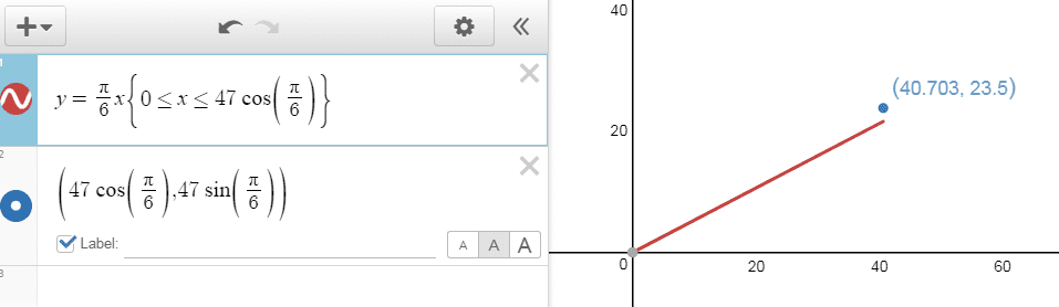

Why is the point not on the endpoint of the line when graphing with Desmos?

ok why is the point not on the endpoint of the line?
Mathematics news on Phys.org
Because $\frac\pi 6\cdot 47\cos(\frac\pi 6) < 47 \sin(\frac\pi 6)$? (Thinking)
ok so $\displaystyle m=\frac{1}{\sqrt{3}}$ not $\displaystyle \frac{\pi}{6}$
