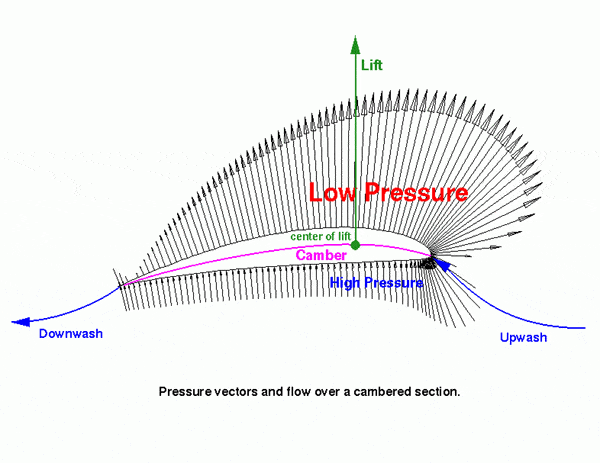

Cavitation is a dynamic phenomenon: either the fluid is moving over something or something is moving thru the fluid, like a propeller blade.
When a propeller blade moves thru a fluid, zones of high and low pressure are created, as shown below:
The magnitude of the low pressure on the upper surface of the blade varies depending on the speed of the blade thru the fluid. If the blade turns faster, the pressure goes lower on the upper surface. If the low pressure drops below the vapor pressure of the fluid, then a cavitation bubble can form on the surface of the blade. The formation of the bubble is not the most serious problem, however. Because the low pressure created by the blade is subject to change, the cavitation bubble can collapse when the ambient pressure of the fluid increases momentarily above the pressure inside the bubble. This collapse can be strong enough to wear away part of the blade surface, causing pits and other imperfections in the blade, which imperfections reduce the amount of lift the blade generates and/or weaken the blade by removing material from it over time.
