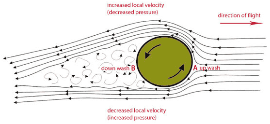

Pictures help:
Considering the picture above, would you consider the velocity of the fluid to be faster above, or below the ball? Obviously above, correct? Because the rotation of the ball is working with the direction of the surrounding flow, the velocity is faster and as a result, the pressure is lower. But at the bottom of the ball, the rotation is working against the direction of the surrounding flow, which slows the velocity and increases the pressure. Using this concept of competing "directions", try to answer your own question using the first image you provided. Would you say the pressure is greater in front of a moving car, or behind it? Now work it out using this image:
Hopefully that helps.
