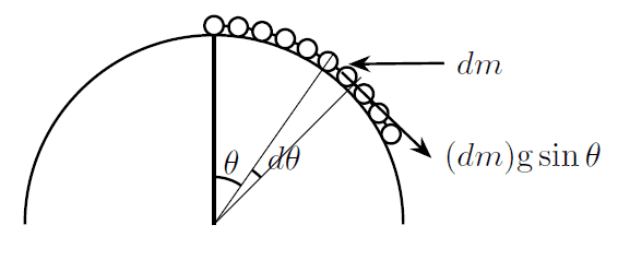

A chain of length ##l\lt \dfrac{\pi r }{2}## is placed on a smooth hemispherical surface of radius R with one of its ends fixed at the top of the hemisphere. What will be the tangential acceleration of the chain when it starts sliding down.
Attempt-1 (Calculus Approach):-
There is an obvious approach by considering the differential mass at an angular position of ##\theta## w.r.t vertical, and then integrating it over all the angular positions at which the chain is present. In the case when the chain just starts to slide the limits of integration will be ##0\rightarrow \theta(=\dfrac{l}{r})##
As, the mass is distributed uniformly along the chain, so its linear mass density is given as ##\lambda=\dfrac{M}{\ell}=\dfrac{dm}{d\ell}##
Now, the length of the differential mass is given as ##\ell=r\cdot d\theta##. Hence, the differential mass of the differential element is given as ##dm=\dfrac{M}{\ell}\cdot rd\theta##
Hence, the tangential force acting on the differential element is given as
$$dF_{\text{t}}=(dm)\text{g}\sin\theta=\dfrac{M\text{g}}{\ell}r\sin\theta d\theta$$
On integrating the differential force for all the elements we get,
$$\int{dF_{\text{t}}}=\dfrac{M\text{g}r}{\ell}\int_{0}^{\theta}{\sin\theta}d\theta\\
\implies F=\frac{M\text{g}r}{\ell}\left(1-\cos\theta\right)$$
As, ##\theta=\dfrac{\ell}{r}##, so the tangential force comes out to be
$$F_{\text{t}}=\frac{M\text{g}r}{\ell}\left(1-\cos\left(\frac{\ell}{r}\right)\right)$$
As, tangential acceleration is given as ##a_{\text{t}}=\dfrac{F_{\text{t}}}{M}=\dfrac{\text{g}r}{\ell}\left(1-\cos\left(\dfrac{\ell}{r}\right)\right)##

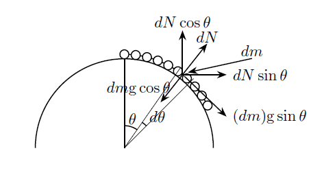

decentfellow said:
all the external forces can be assumed to act on the center of mass
That is true of the gravitational forces, but the normal force will be greatest near the top of the chain.
For determining the motion of the CM, it is true that you can treat the CM as a point particle of mass M acted on by all of the external forces.
Does the net normal force have a component in the direction of ##a_t## of the CM? (I think this is related to haruspex's comment.)
Also, does the CM have the same value of ##a_t## as the chain, or do they have the same angular acceleration?
TSny said:
Does the net normal force have a component in the direction of atata_t of the CM? (I think this is related to haruspex's comment.)
Hmm...after what you and haruspex said I think that I was indeed missing that point but I had some trouble finding the components of Normal reaction to make it easier to find the tangential component of the normal for the center of mass. My work is as follows:-
$$dN_x=dN\sin\theta=dm\text{g}\cos\theta\sin\theta=\frac{M\text{g}r}{\ell}\sin\theta\cos\theta d\theta=\dfrac{M\text{g}r}{2\ell}\sin(2\theta)d\theta\\
\implies \int{dN_x}=\dfrac{M\text{g}r}{2\ell}\int_{0}^{\theta_0}{\sin(2\theta)}d\theta=\dfrac{M\text{g}r}{4\ell}\left(1-\cos2\theta_0\right)$$
$$\theta_0=\dfrac{l}{r}$$
$$dN_y=dN\cos\theta=dm\text{g}\cos^2\theta\\
\implies \int{dN_y}=\dfrac{M\text{g}r}{\ell}\int_{0}^{\theta_0}{\cos^\theta}d\theta=\dfrac{M\text{g}r}{\ell}\left(\theta_0+\dfrac{\sin2\theta_0}{2}\right)$$
But, the resultant of the two components isn't ##\displaystyle\int{dN}=\displaystyle\int_{0}^{\theta_0}{dm\text{g}\cos\theta}=\dfrac{Mgr}{\ell}{\sin\theta_0}##

You integrated N as though it is a scalar.
Didnt I separate into componenets o_O? Or are you talking about the other one, i.e. ##\displaystyle\int{dN}=\displaystyle\int_{0}^{\theta_0}{dm\text{g}\cos\theta}=\dfrac{Mgr}{\ell}{\sin\theta_0}##
And if you are talking about the last one then my first attempt on integrating the tangential force for all of the chain was also similar, but the answer was correct. So, if it is the last integration of ##dN## that I am doing wrong then is the first attempt correct?
decentfellow said:
are you talking about the other one, i.e. ##\int{dN}=\int_{0}^{\theta_0}{dm\text{g}\cos\theta}##
Yes.
Your original attempt was ok because as the tension in one element is transferred to the next one up it gets rotated through dθ, much like a rope over a pulley.
I am not able to comprehend as to how that affects the components of the normal.
Your original attempt (1) did not consider the normal.
What you did in effect (though you did not set it out this way) was to consider the tensions each end of each element and the weight of each element.
Because the tensions each end of an element are not quite aligned, you should technically consider the net tangential force from the tension as something like ##T(\theta+\Delta\theta)- T(\theta)\cos(\Delta\theta)##. But for small Δθ, cos(Δθ) approximates 1. So ##T(\theta+d\theta)- T(\theta)+g\sin(\theta)dm=a_tdm##. Integrating, the tension disappears, since it is zero at both ends.

decentfellow said:
$$\int{dN_x}=\dfrac{M\text{g}r}{2\ell}\int_{0}^{\theta_0}{\sin(2\theta)}d\theta=\dfrac{M\text{g}r}{4\ell}\left(1-\cos2\theta_0\right)$$ $$\theta_0=\dfrac{l}{r}$$ $$ \int{dN_y}=\dfrac{M\text{g}r}{\ell}\int_{0}^{\theta_0}{\cos^\theta}d\theta=\dfrac{M\text{g}r}{\ell}\left(\theta_0+\dfrac{\sin2\theta_0}{2}\right)$$
I believe these are correct. You know the direction of the acceleration of the CM. So, what is the component in this direction of the total normal force?
In that case it doesn't make any sense to me to define tangential acceleration for the chain as it is an extended body, angular acceleration would have been more sensible to me. So, what is the significance of tangential acceleration of the chain.
Each link has a tangential acceleration. The magnitude of this acceleration is the same for each link, and I think that's what they are asking for.
How does the magnitude of the tangential acceleration of a link compare to the magnitude of tangential acceleration of the CM?
