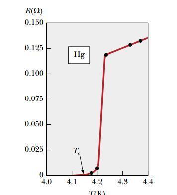

Hello. The measurement of electrical resistance as a function of the superconductor's temperature yields fundamental insights into its properties. The Critical Temperature, Critical Current Density, and the Critical Magnetic Field, can all be obtained through variations of a basic experiment.
I would like to ask you. Why is the transition in resistance gradual at the Critical Temperature (T0) on plot of resistance versus temperature ? ( see the attached picture ). Thank you !

The different regions in the superconductor aren't reaching critical temp at the same time.

Like when you heat mashed potatoes in the microwave. They don't heat evenly right away. The same thing happens when you try to cool objects too.
It also has to do with the quality of the superconducting film/material. The Tc of a superconductor depends on how uniform and pure the material is, meaning how steep the transition is will largely depend the quality: a "bad" film will always have a wide transition. This is one reason why the width of the transition is often used as a figure of merit when reporting on the quality of e.g. high-Tc materials.
