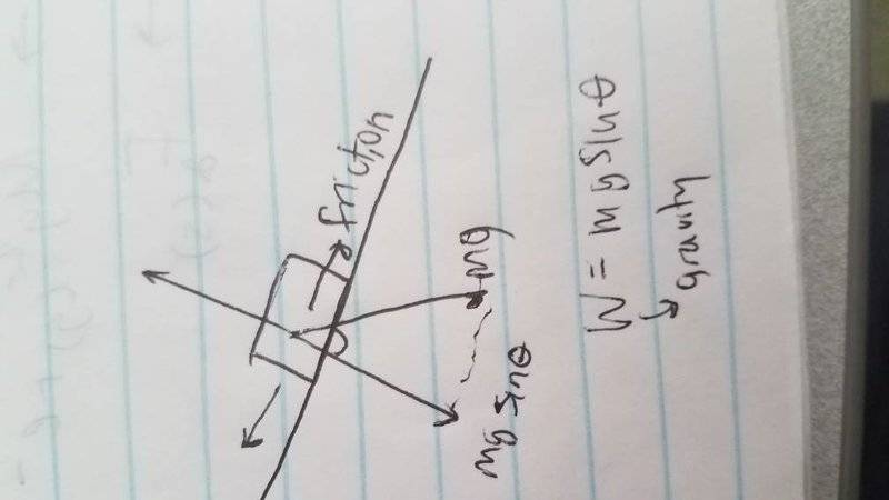

A block is pushed so that it moves distance L up a ramp (incline angle q ) at constant speed. If there is friction, the magnitude of the work done on the block by friction…(ramp is up and leftwards)
A. is mgsinqL.
B. is less than mg sinqL.
C. is greater than mg sinq L.
D. could be greater or less than mg sinqL.
E. is zero
(q is angle of ramp and L is displacent by hand)
So I thought that the answer would be A. If we are talking about the friction work's magnitude then the value is positive work. Since mgsinqL is negative work, wouldn't it be greater than? Why is the answer D?Thank you. Stressing out about physics late at night >.>..

I always thought that friction force would balance out the applied force because the object is at constant speed.
I attached a image below of the ramp
Yes, the friction force will match the sum of all the other applied forces. What are all the other applied forces? Is gravity the only one?
Likes Lori
The normal force would balance out the gravity force right? The x component of gravity force will balance friction force?
Normally yes, but if that were the case here, the block would either be in equilibrium, or slide down the incline, wouldn't it?
Isn't there someone pushing the block up with a finger?
Likes Lori

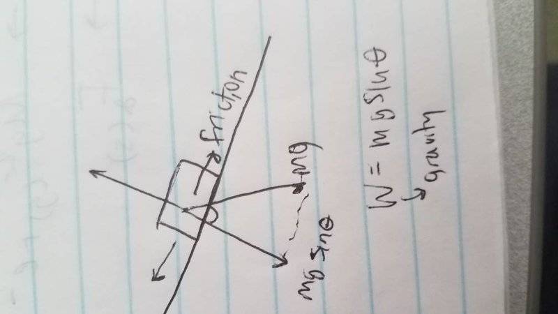

I think I understand now. Friction and the x component are both forces that affect work. We just don't know if friction is greater or less than force of gravity in its x component.
Lori said:
I think I understand now. Friction and the x component are both forces that affect work. We just don't know if friction is greater or less than force of gravity in its x component. View attachment 213985
Indeed!
