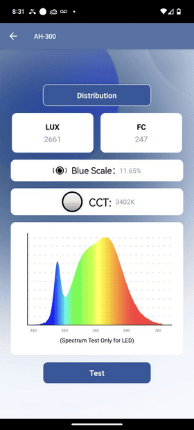

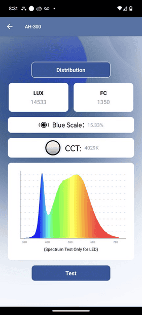

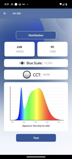

Hi! Man, I haven't posted here in a while... So I bought a cheap spectrometer and have been measuring light output of many many things. One thing is common from ALL of my readings.. Each LED or light bulb I measure has a sharp, tall narrow band of blue being put out and then a drop off of cyan/lime green and then a bell curve of the other colors. See these two images. One is from my range hood in my kitchen, the other is a 60 watt bulb in my living room.
Why is blue so removed from the rest of the bell curve? Why isn't it part of the main bell curve?

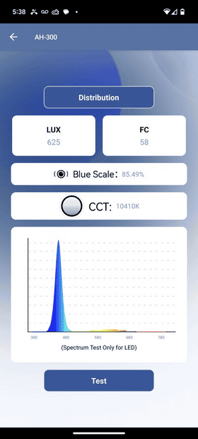

Now look below at some of my plant grow lamps. One of the lamps is UV-A freqency. When I look at the light when it's on, it's to my eyes a very light purple. When I look at the graph below though, it starts roughly at 390nm but the graph shows it as a dark blue. Shouldn't it show violet in at least some amount?

I know very little about this subject but I am very suspicious of the shape of those curves. They look both smooth (which I would not expect from any light source) and similar (whoch makes me wonder if they're copies).
Most "white" LEDs are including an UV-excitation source surrounded by phosphor material reemitting light in the visible range. That UV peak is coming through and you can observe it by spectrometer.
Likes DaveE and Newtons Apple

Interesting.. is this a property of LED lights in general? Will all LED's have a significantly higher UV peak towards the blue then? WHy is this needed?
View attachment 354433View attachment 354435
The "60 Watt bulb" you mention apparently is a standard LED replacement bulb with an output giving approximately the illumination level as a 60 Watt incandescent bulb. To the human visual system it appears to produce White light.
Judging from the spectrum you show, the actual LED in this bulb produces a narrow band of blue light. The broad-band portion of the spectrum is due to the presence phosphors (as mentioned by @Gleb1964 above) which fluoresces.
Now look below at some of my plant grow lamps. One of the lamps is UV-A frequency. When I look at the light when it's on, it's to my eyes a very light purple. When I look at the graph below though, it starts roughly at 390nm but the graph shows it as a dark blue. Shouldn't it show violet in at least some amount?

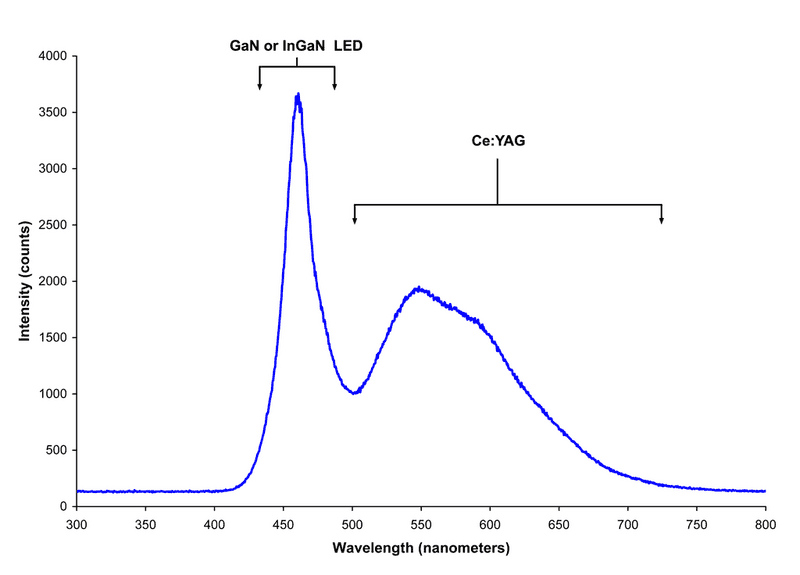

The following figure is from the above Wikipedia page
The following information for figure comes from Wikimedia Commons.
Original uploader description: Spectrum of a "white" LED showing blue light directly emitted by the GaN LED and the stokes shifted yellowish light emitted by the Ce:YAG phosphor. Spectrum taken by me (Deglr6328) using an Ocean Optics HR2000 spectrometer [http://www.oceanoptics.com/] with a high-OH solarization-resistant fiber optic light guide. This spectrum is not calibrated for intensity.
Author: The original uploader was Deglr6328 at English Wikipedia.
