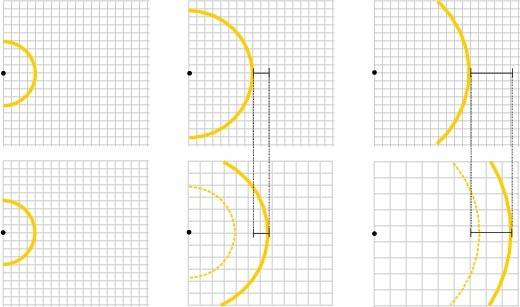

Regarding the size of the observable universe, the universe is larger than it is old times the speed of light because of the expansion, as Orodruin says. Here is a graphic I've put together to hopefully clarify:
The top row shows an expanding shell of light from a central point (say, our position in the universe) for the case of a static universe (the grid doesn't grow as time progresses, from left to right). The size of this shell grows simply as t*c, where t is time and c is the speed of light. The bottom row shows this same expanding shell when the universe expands (notice how the grid does grow as time progresses, from left to right). Since light travels through space, as space expands it carries the light along with it. The growth in size of the light shell due to the expansion alone is given by the dashed yellow line in each frame in the bottom row; the additional growth in going from dashed to solid in each frame is due to the light traveling relative to the expanding space. So the light in the bottom row grows by time t to a size greater than t*c.
A great way to explain this visually!

I think this graphic has a great pedagogical value

and could clarify superluminal recession velocity as well by interchanging the order of the dashed and solid lines.
I have never seen such a graph, it seems a good complement to the well known spacetime diagrams of Davis&Lineweaver.
