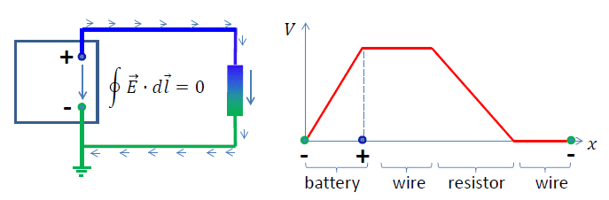

Why is there electric field outside a battery?

Correct me if I'm wrong,but a battery's electric field is like an electric field of a capacitor consisting of two plates.But we know that the electric field outside the two plates is zero.So why does an electric field form outside the battery and into the circuit?

This image from post #15 is helpful. Line integral of E.dl outside the battery is equal to the line integral of E.dl inside the battery. So when you traverse a complete loop, you can see ∫closed loopE.dl=0.
Likes swampwiz, Fisherman199 and sophiecentaur
