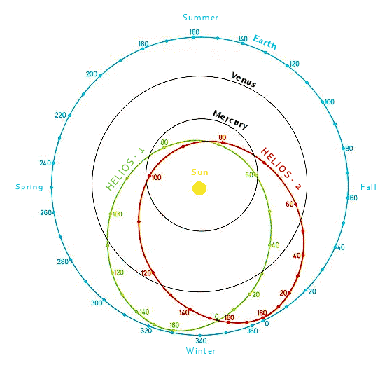

The closest vehicle to the sum \was Helios 2.
https://en.wikipedia.org/wiki/Helios_( spacecraft )#Launch_and_trajectory
(I think Helios 2 was also called Helios II and Helios B.) If calculations indicate that there is plausibly an observable amount of DM inside the RDM.test radius, then presumably observing the orbit of a vehicle passing closer to the sun than RDM.test might show some DM is there. A vehicle transit even closer to the sun would improve chances of finding DM.
Regards,
Buzz
