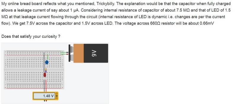

I have wired in series: + of 9V battery --- + of 1000 uF capacitor --- 660 Ohm resistor --- + of a green LED --- - of the 9V battery. Remark: the 9V battery is a bit depleted 7.8 V unconnected.
Voltage drop across the capactor is 6.5V, across the LED is 1.5V but 0V across the resistor. Why there is no voltage drop across the resistor?
Try this:
1) discharge the capacitor by placing the resistor across it for several seconds.
2) connect everything back up except the LED to - of the battery
3) connect the - of the battery while carefully watching the LED.
What did you see?
4) now remove the capacitor
What do you see now?
Do you understand how capacitors work?
EDIT: Let me rephrase that: you clearly don't yet understand how capacitors work, so that's where you should focus. Study capacitors for a bit and you will understand what is happening in your circuit. That's where rbelli1 is leading you.
