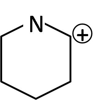

Why does the following structure show resonance?
The question was given by my teacher and he said that yes it will show resonance. But i still can't able to make it out why would it show resonance? The point is Nitrogen is more electronegative than Carbon and therefore should not show resonance but yet it does. It passes one of its electron from the lone pair to the carbon and makes a covalent bond. I don't agree with this because nitrogen is more electronegative and should avoid giving its electron to the carbon.
Any help is much appreciated.
Thanks! :smile:
Can i expect a reply? :rolleyes:

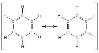

Hi Pranav-Arora! :smile:
I just looked up the wikipedia definition of resonance.
Turns out that if you can form covalent bonds in different ways, the actual molecule is neither, but a hybrid form in between.
As it is, benzeen (C6H6) has 2 different covalent bond structures as you can see here:
Resonance structures of benzene
The same would be true if you replace one of the carbon atoms by a nitrogen atom.

I already know about the things you just posted and that's not the main problem for me. I asked why the nitrogen atom would ever pass its electron to carbocation even if it is more electronegative. Nitrogen should not give its electron to carbon due to higher electronegativity character.
The difference is not that high, around 0.5 unit.
Seems to me that nitrogen can form different bonds with the 2 carbon atoms next to it regardless of its electronegativity.
This would imply a resonance structure.
(But I'm not a specialist. :shy:)
Only 0.5? lol
What if we replace Nitrogen with Oxygen?

you can make a triple bond on nitrogen making it positive so yes there is resonance.
EN doesn't stop anything from performing resonance. Except most likely your prof will say not to touch the benzene ring.
