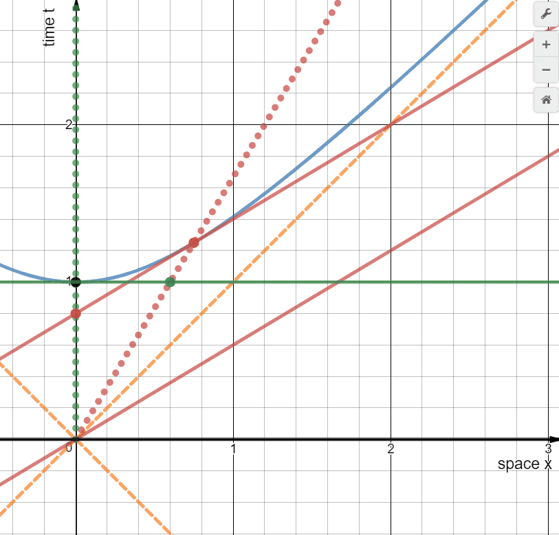

"Time is orthogonal to space" in Minkowski Spacetime, as defined by Minkowski himself when he formulated "spacetime" (and "light cone" and "worldline" etc...).
From my post on StackExchange
From Minkowski's "Space and Time"... [bolding by me]
(e.g. http://www.minkowskiinstitute.org/mip/MinkowskiFreemiumMIP2012.pdf , p47)
We decompose any vector, such as that from [itex] O[/itex] to [itex] x, y, z, t[/itex] into four components [itex]x, y, z, t [/itex]. If the directions of two vectors are, respectively, that of a radius vector [itex]OR[/itex] from [itex]O[/itex] to one of the surfaces [itex]\mp F = 1[/itex], and that of a tangent [itex]RS [/itex] at the point [itex] R[/itex] on the same surface, the vectors are called normal to each other. Accordingly, [tex]𝑐^2𝑡𝑡_1−𝑥𝑥_1−𝑦𝑦_1−𝑧𝑧_1=0[/tex] is the condition for the vectors with components [itex]x, y, z, t [/itex] and [itex] x_1, y_1, z_1, t_1[/itex] to be normal to each other.
In other words,
locate the intersection of an observer's 4-velocity with the unit-hyperbola (the Minkowksi circle) centered at the tail of the observer's 4-velocity.
The tangent line to that hyperbola is Minkowski-perpendicular to that observer's 4-velocity. That observer's x-axis is drawn through the tail of her 4-velocity, parallel to that tangent line.
The "intuition" to have is that
the tangent to the "circle" in that geometry
is
orthogonal to the radius vector.
This orthogonality also holds in Galilean spacetime.
Both of these spacetime-orthogonalities are natural generalizations of Euclidean space.You can play around with this idea in my visualization [screencaptured below].
https://www.desmos.com/calculator/r4eij6f9vw
Play around with the E-slider to see the Galilean (E=0) and Euclidean (E=-1) analogues!
  • The blue "circle" is the metric
  • The dotted radial lines are worldlines of inertial observers that met at event O, representing time for each of them.
  • The tangent lines are normal [orthogonal, perpendicular] to the radial lines.
    These correspond to "all of space at an instant of time according that observer".
  • The line through the origin O parallel to the tangent line defines the "x-axis" of that observer at event O.
