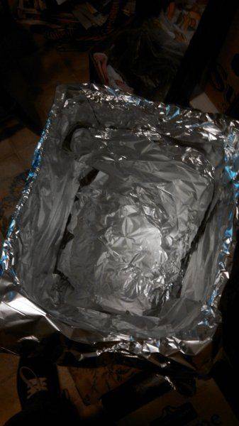

So I made this Faraday Cage to block wifi in all directions but 1, to block it from my neighbor. Each side has 6 Layers of aluminum foil on it with no gaps, It looks sloppy because when I tried it and it didn't work I quickly added more trying to make it work. If I put my router inside this, with the opening facing AWAY from me, and i stand 20 feet behind it, I still have full wifi signal, It does not affect my wifi at all. I even tried putting my cellphone inside the Faraday Cage facing away from my router and once again it did not affect my wifi signal. Why does my Faraday Cage not work? Everything I've researched says it should completely block it.

Try closing up the cage completely and see how that effects the signal. I'm not too familiar with blocking wi-fi signals, but our EMP shielding facility in the military had to have literally every little crack and gap blocked off in order to function properly. (Of course, when you're trying to block a high-altitude EMP even a small portion getting through can devastate your electronics inside) It's possible the cage is merely reflecting all of the signal out of the opening where it just diffracts and reflects around to get to you.

The WiFi signal will likely still reach you by three routes.
1. I can see gaps in the foil, and an EM wave will pass through the slightest crack, even a knife cut, provided the crack is more than half a wavelength long (about 7 cm long).
2. The signal emerging from the open end will be of normal strength (or maybe greater), so it will be reflected and scattered back in your direction by the walls and objects in the room.
3. The emerging wave will be diffracted in all directions at the edges of the screened box.
It cannot work if it has a big opening ! The RF will be pouring out and radiating everywhere
You don't have a Faraday cage ... you have a lined box with an opening on one side. A Faraday cage has NO OPENINGS that are bigger than around 1/8 wavelength at the frequency that needs to be blocked
You are NOT going to block your WiFi going to your neighbour's house unless you either put all of your or their house inside a really big Faraday cage

Aluminium foil has a layer of oxide all over it. There resistance across the join between sheets will be very significant at any contact points where the sheets are not actually under pressure. What is the spacing between screws / rivets etc.? I think it should be less than λ/4 (that always seems to be a magic quantity in RF). Current can flow through the most insignificant cracks.
But what you describe is not, in fact a Faraday Cage. A 'Faraday Cage' does NOT have an open side; it is a closed surface / box.
If you want a bit of directivity then put your router behind a large plate of metal ( several wavelengths across) , between you and the interfering source.
But if you are trying to screen one digital signal from another, you should not need a high degree of isolation - 20dB ratio of signals should start to give you a pretty good advantage for the wanted signal. It has already been mentioned that choosing a different channel should remove the problem completely. (That is unless your neighbour is using an illegal power from his router - which is unlikely)
This was the key comment from Joey B
in other words he was expecting his screened box to stop his wifi signal going out the screened side
He doesn't understand
1) what a Faraday Cage is
2) once his wifi signal exits the open side of his screened box its going to be easily received anywhere around the box, the room and beyond
and the screening of the box between him and his wifi router is not going to be effective and hence his neighbours will still be able to access his wifi
