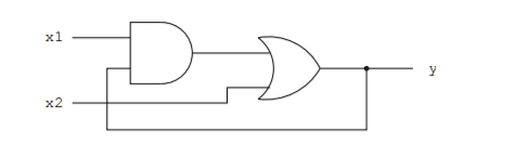

I haven't understood how we deduce that the circuit in figure 8.3 ( page 3 from the link- 120 from the book) is not a combinatorial circuit.
Do we have to find the expression that represents it? If so, how do we do so? (Thinking)

Hey evinda! (Smile)
It says in the book:
A combinatorial circuit is a circuit whose output is uniquely defined by its inputs.
and:
If x1 = 1 and x2 = 0 then y can be 0 or 1.
So the output is not uniquely defined by its inputs.
And that's why the circuit in figure 8.3 is not a combinatorial circuit. (Thinking)

evinda said:
But, why is it like that? Since at the circuit there aren't said any inputs, we can go anywhere with input either 0 or 1 ?(Thinking)
I don't understand your question.
The problem is really that there is a (so called feedback) loop in the circuit.
If we verify what happens when x1 = 1, x2 = 0, and y=0, it turns out that all logic gates can work as intended, and that the result is 'true'.
But the same thing applies if we verify what happens with x1 = 1, x2 = 0, and y=1.
Without feedback loops this is not possible, and the output is always unique.

Let's start at the left with the first AND gate.
Here we are confronted with the feedback loop, while we do not know yet what $y$ is.
Let's keep $y$ unknown for now.
Then we get:
$$(x_1 \land y) = (1 \land y) = y$$
Now we apply the OR gate, yielding:
$$(x_2 \lor y) = (0 \lor y) = y$$
As we can see, whatever $y$ is, that's also what we get back at the end.
So any value of $y$ will do.
That is, there is no unique value of $y$ for the given inputs.

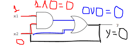

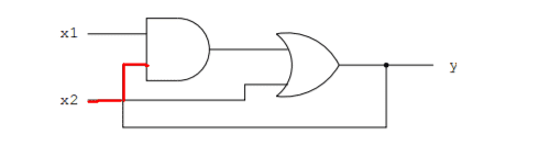

I was talking about this circuit:View attachment 6859
and I meant the red marked path that connects $x_2$ to the AND-gate:View attachment 6860If $x_1=1$ and $x_2=0$, I thought that the following is done:View attachment 6861
Am I wrong? (Thinking)

I'm afraid that the wire from $x_2$ crosses the other wire and is not connected to it.
It's different for the other intersection of wires on the right side. There is black knot there to indicate that those wires are connected.
So $x_2$ is connected to the second gate and is not connected to the first gate. (Thinking)

Ah I think I understand. So after each loop, the result is $y$ and so it is not unique, right? (Thinking)
$y$ is indeed not unique, but it doesn't change with each loop.
If we assign $y$ the value of $0$, the circuit is consistent.
So $y=0$ is a valid output.
However, the same holds true for $y=1$.
And that's why $y$ is not unique. (Thinking)
