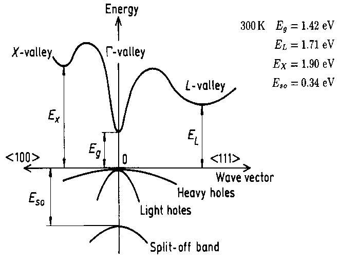

Alright, but let me take a simple example like a semiconductor with a direct band gap, like GaAs. It starts absorbing light when the incident photo energy is ~1.4eV, and it can absorb higher energies than that as well. Why does it stop absorbing higher energy photons at some point? Is it because, to absorb higher energies, the transition has to happen from a spot in the valence band to a spot in the conduction band with the same k value, but the conduction band doesn't increase indefinitely?
Yes, exactly. But note that in general there will be more than one band and for photons of high enough energy, you can get photoionization.
Thank you for the response. As a follow up question: The band gap energy is a well defined concept, but is there a name for the upper limit on energy that the semiconductor can absorb because of the mechanism I just said?
I am not sure. The point is the following: The lower band gap is a reasonably well defined concept as it is the lower limit for one particle and consequently also many particle excitations (this is already simplified as there may be excitations inside the gap, like bound electron hole pairs). However there may be electronic excitations which correspond to multi-particle excitations and may be excited by absorption of light, which fall into a higher band gap of single particle excitations.
The point is that electron electron interaction is very strong, so that it renders a single particle picture invalid in most parts of the spectrum. The only exception being the excitations of lowest energy.
You may want to read about the Landau Fermi liquid theory to better understand what I am talking about.
