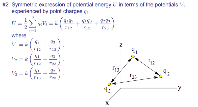

My question is, why it's 1/2 [qiVi]? Shouldn't it just be qiVi?
Thank you ...
You want to count "pairs"...
That is, if you include both [itex]\frac{q_1q_2}{r_{12}}[/itex] and [itex]\frac{q_2q_1}{r_{21}}[/itex], you are counting the same "pair" twice.

Oh I see,
