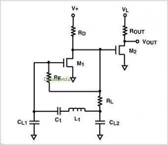

Such a circuit will usually only oscillate when you do not want it to (cf. Murphy's law). Try this circuit instead:
(copied from http://www.datasheetdir.com/Nanopower-Lc-colpitts-Oscillator-Circuit+Application-Notes, you can find component values there).
