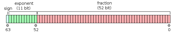

Here's a diagram of the IEEE double precision floating point representation:
This format is specialized for expressing numbers in the form 1.<fractional_part>*2<exponent>. Note that the 1 that precedes the binary point is not stored. With an infinite amount of storage, every computable number could be expressed in this binary format. Computers don't have an infinite amount of storage, so the floating point representations are a poor man's alternative to the pure mathematical form.
Suppose the fractional part of some number is all zeros except for the very last bit, which is one. What's the difference between that number and the corresponding number in which the fractional part is all zeros? That's the ULP that Jim wrote about. Of course if the exponent is very large the ULP is going to be very large also. It makes a more sense to talk about the ULP when the exponent is zero than any other exponent, and that's how the machine epsilon is defined.
