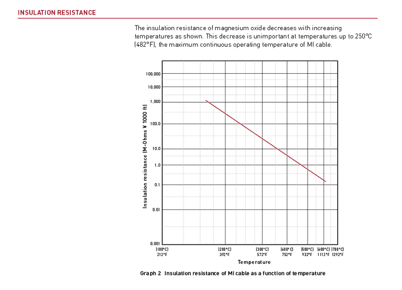

The limitation in temperature gradient should limit the rate of heat transfer, as additional power will increase the temperature of the heating wire and thus exceed the maximum temperature gradient to the surrounding. but does the change in the electric resistivity of MgO with increasing temperature that significant? most of the available heating cable have a maximum of only 600 V and MgO have a very high dielectric strength!
Please refer to this pdf file. The resistivity of MgO do decrease with temperature but it is still very high.
and in http://www.emersonindustrial.com/en-US/documentcenter/EGSElectricalGroup/products_documents/heating_cables/commercial_heating_cables/commercial_pipe_tracing/mi_comm_pipe_trace_cable/308-SA-001_Mineral_Insulated_heater_cable_lit.pdf , the resistivity of the heating wire is presented and it is very small that it will always be much less than the resistivity of MgO insulation (using the graph above) so I though there should be no worry from short circuit, however they set a maximum temperature of 350 C and maximum voltage of 600 V. What is wrong with my understanding of this data and graphs?

Maximum operating voltage determines electrical insulation requirements.
The durability requirement is determined by the maximum specified operating temperature of the inner conductor.
The mineral insulation needs to be both thermally conductive and electrically resistive.

So to sum up, current commercial heating cables handle a maximum of 2 kV, because the currently available insulation (MgO) can not insulate higher voltages in field conditions?
... and conductors (heating elements) with high enough resistance to function as heating elements (10-100 W/m) at applied voltages greater than 2 kV are too fragile.
