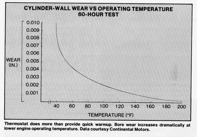

For 60 Hour engine wear tests:
At 20C coolant temp, cyl wear = .008"
At 68C coolant temp, cyl wear = .001"
At 98C coolant temp, cyl wear = .0003"

Low coolant temp allows fuel to condense on the bores, removing the lubricant film

In cylinder is 800C-1000C ,how condenese can exist in that hight temperature?
And when you drive on 60C thermostat I think there is no condese,but still wear is higher then 90C coolant..
When an internal combustion engine sets overnight the mechanical components will be cooler than when at “ideal” operating temperature.Engine wear is most experienced at cold start due to the lack of oil available to engine components.The dimensional tolerances will be at the non-ideal design limits.
Maximum clearances in all bearing and piston to wall specifications.
The piston will be an oval shape having not expanded to true oval for minimal clearance. Some piston slap will cause some wear on the piston skirts until thermal expansion maximizes.
No lubrication oil will be top side or on the cylinder walls.
This is where the most “wear “ occurs. Metal to metal and no lubrication. Why? The oil pump galleries may be dry with no oil present.
Today 99% of the cars on the road use mechanical oil pumps. This means the pump oil pump cannot deliver oil pressure until it has sucked up the oil from the oil pan sump and has begun pushing the oil through the oil galleries.
From cold start until the engine warms up and the oil fills all the oil galleries and we have a steady oil pressure reading we do not have proper lubrication.It was true that we suffered a lot of cylinder / piston wear about 20 years ago. The cylinder walls used to be honed and finished with many peaks and valleys remaining in the surface profile.
The introduction of Plateau Honing meant the peaks were knocked down on final hone pass so the engine break in time was a lot shorter and we had significantly more valleys to retain oil.Todays computerized fuel monitoring means we do not have excessive fuel splashing on cold cylinders at start up unlike the day of the “choke”.
Your assumption that ”thicker oil” does better lubrication is not true today with the introduction of synthetic oils. Cold start lubrication is best achieved from an oil with good cold flow Properties.
The reason the 98C wear is the least is the engine is functioning properly. At 20C the engine is way too cold and piston rings are permitting too much blow, washing the lubricating oil off the cylinder walls. The piston is not thermally expanding for a tight piston ring seal. When the oil is not heated to proper temperature harmful deposits, moisture, and acid accumulate rapidly, then eat away at the inside of your engine. There is a lot of chemical things happening during the combustion process so you must change engine oil at least every 3 months regardless of the miles driven. You literally have acid and sludge developing in the crankcase.

The bore is not itself at such a high temperature, but more like 150C. Higher temperatures also promote the flow of oil to the compression ring where most wear (and also power losses) occur. You might like to look at the following paper:-
Ok so "blow by" is main reason for engine wear which operate on lower coolant temperature(lower thermostat openning).

So engine wear is 3 times more when engine operate on 68C coolant temperature instead 98C !
0.001" : 0.0003" =3.333
You think that most reason for this big difference in wear is blow-by, because piston ring is not close the gap enough?
Ok , we will try this one more time.
An engine operating at the proper 98 ° C will have wear but it will be the minimum you can expect.
An engine operating at 20 ° C will cause sludge, destroy the oils ability to lubricate and cause much more piston to cylinder wall wear.
I believe I have explained in great detail the reasons.
