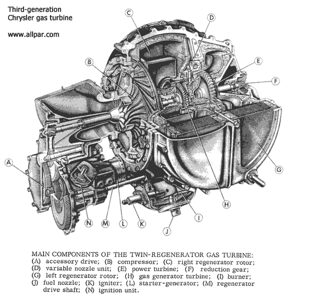

Turbine engines have been used earlier by Chrysler. If throttle response is a reason they aren't prevalent there are many ways to reduce it. If I am not wrong, the compressor can have variable geometry vanes(similar to VGTs) and thereby reduce lag.
I learned that it is less fuel efficient..but it also said that any fuel can be used to combust the mixture and pass it on to the turbine. (not just petrol or diesel) There could be another a less expensive option to counter this inefficiency.
Apart from this, can there be other reasons as well?

Turbine engines aren't used for a number of reasons.
1) Their idle and low-load fuel efficiency is appalling. Most car engines spend the majority of their lives far from peak power output, so turbines' high efficiency at high load wouldn't really help them here.
2) Throttle response. Sure, this could be improved with all kinds of variable geometry stuff, but we already have something with perfectly good throttle response.
3) Cost. Turbines rely on high temperature and tight clearances to get efficiency and high power output. Components that can maintain tight clearances at high temperature are expensive.
4) They really don't have any major benefits. Why fix what isn't broken?

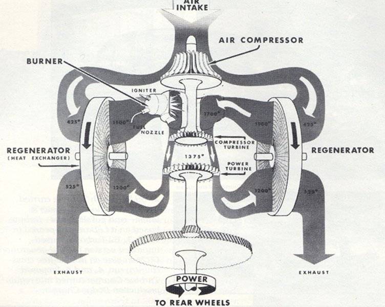

A viable gas turbine for a car would not be a simple single shaft design . Two shaft gas generator and a power turbine stage would be needed to give good efficiency over most of the power range and a give a relatively low output shaft speed to avoid drive train problems . It would be an expensive option right now but rapid developments in gas turbine manufacturing technology are likely to bring cost down a lot in next few years .
Out of curiosity, what makes you think that there are likely to be rapid developments in gas turbine manufacturing that will bring down the cost in the next few years? Gas turbines are well understood, and have been manufactured en masse for well over half a century now. If anything, the trend recently has been towards higher initial cost to improve efficiency, not towards low-cost turbines, and I'd be very curious to know why you think that will change.
That having been said, I absolutely agree with you that a multi-shaft design would be much better for a car. Single shaft, while a nice concept, introduces a lot of difficulties that could be nicely sidestepped through an intelligent multi-shaft design.

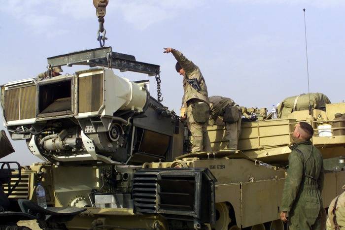

When nothing matters (cost, efficiency) besides power density, turbines are sometimes the way to go. Honeywell AGT1500, 1500 HP, 2750 lb-ft torque.
AGT1500_engine_and_M1_tank.JPE
