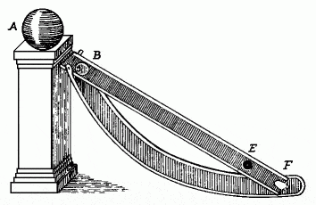

UltrafastPED said:
Your suggestion reminds me of the title page for Simon Stevin's "Mechanics"
See the image at http://www.lhup.edu/~dsimanek/museum/unwork.htm#stevinprob
I think it's more like this one:
From : http://www.lhup.edu/~dsimanek/museum/people/people.htm (search for Bishop John Wilkins)
