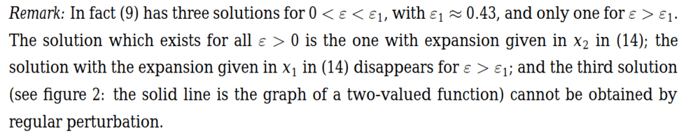

Ref1 in my original post claims that using "regular" purterbation is not enough to find all the possible solutions for the following equation ##x^{2}-1=\epsilon e^{x}##
But it is enough to find the solutions of ##x^{2}-1=\epsilon x##
