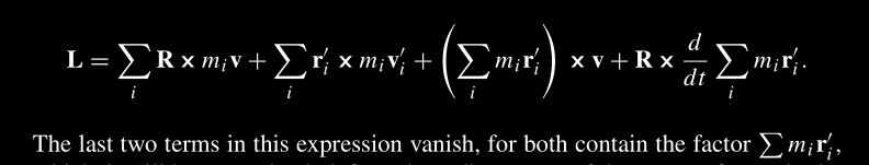

Why position times mass is equal to 0 here (vanishes)?

$$\sum_i m_ir_i$$
Why the term always vanishes?
There's some more equations where the mr was vanished. But, they didn't explain why it vanish. Why the term vanish? I think that's for position 0,isn't it?

If the origin is taken as the centre of mass, then the sum is zero by definition.
I think the origin is at an arbitrary position. Vector ##\vec R## is the position of the CM of a rigid body relative to the origin. This looks like part of the proof that the angular momentum of a rigid body is the sum of the angular momentum of the CM (orbital) and about the CM (spin). The primed coordinate ##\vec {r_i}'## is the location of element ##dm_i## relative to the CM, i.e. ##\vec {r_i}'=\vec r-\vec R##. Otherwise yes, the sums are zero by definition of the CM.
Define ##\vec R## as the position of the CM relative to an arbitrary origin and ##\vec r## and ##\vec {r_i}'## respectively as the position of ##m_i## relaitve to the origin and relative to the CM. Then ##\vec r_i = \vec R+\vec {r_i}'## so you can write the position of the CM relative to the origin, $$\vec X=\frac{\sum_i m_i\vec r_i}{\sum_i m_i}=\frac{\sum_{i} m_i(\vec R+\vec {r_i}')}{\sum{_i} m_i}=\vec R+\frac{\sum{_i} m_i\vec {r_i}'}{\sum{_i} m_i}.$$ By definition, ##\vec X = \vec R##. The only way for this to be true is to have ##\dfrac{\sum_i m_i\vec {r_i}'}{\sum_i m_i}=0.##
