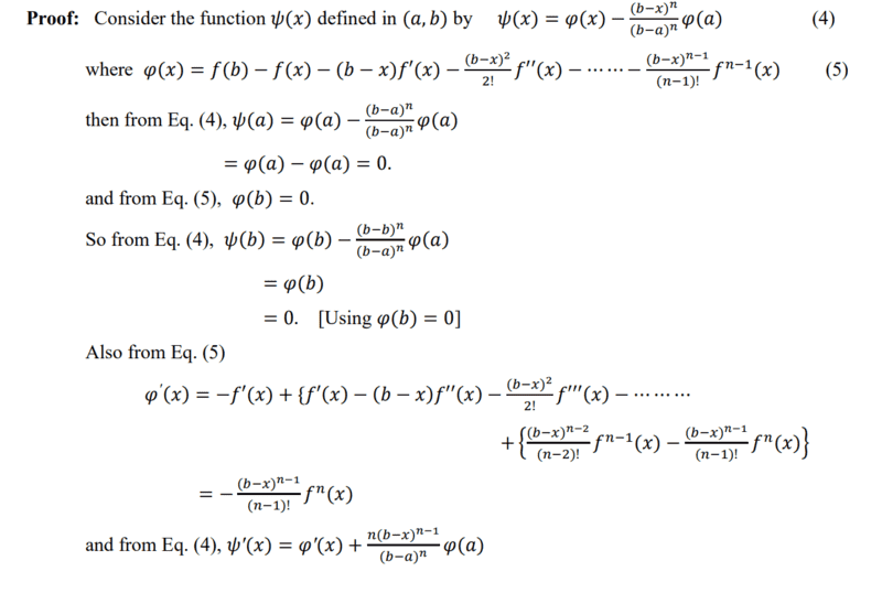

I am using a book where they prove Taylor's theorem with p(x)=q(x)−((b−a)^n/(b−x)^n)q(a). I have included a proof of mean value theorem where they shows how they get h(x) = f(x) – f(a) – {(f(b)-f(a))/(b-a)} (x - a). Is there any similar way to show how they come up with the p(x)?

Now here is a proof of Taylor's theorem:
Consider the function $p(x)$ defined in (a, b) by p(x)=q(x)−((b−a)^n/(b−x)^n)q(a) where q(x) = f(b) - f(x) - (b - x)f'(x) - {(b-x)/2!}f''(x) -... {(b-x)^{n-1}/(n-1)!}) f^{n-1}(x)

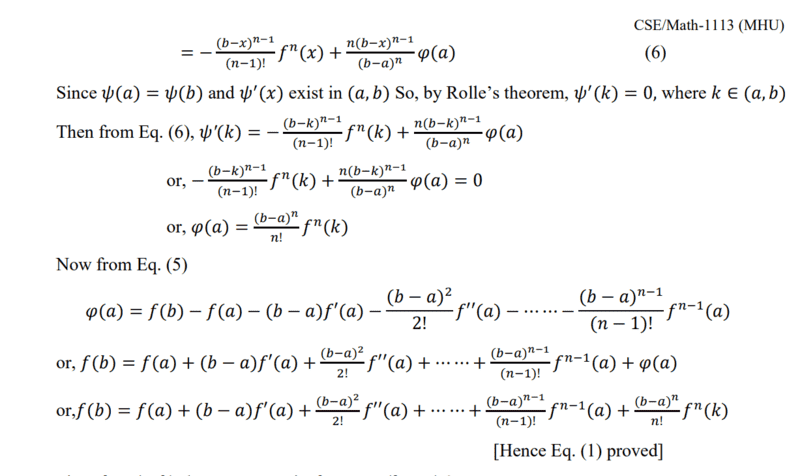

Then they show that, p(a)=p(b)=0 and apply roll's theorem and proves Taylor's theorem. I understand this part.
I don't understand why they use, p(x)=q(x)−((b−a)^n/(b−x)^n)q(a). When proving mean value theorem, they first derived h(x) = f(x) – f(a) – {(f(b)-f(a))/(b-a)} (x-a) and then applied rolls theorem. My question is what is the derivation of p(x)=q(x)−((b−a)^n/(b−x)^n)q(a). p(x)=q(x)−((b−a)^n/(b−x)^n)q(a) and h(x) = f(x) – f(a) – {(f(b)-f(a))/(b-a)} (x-a) seems similar to me. Can we derive p(x) the same way as they did for h(x)?

Here is the proof:

Can you tell us the location where you have the problem, in the same terms as in the pictures?
The proof basically goes like this:
  • the partial sum (plus correction terms) of the Taylor series at ##x=a## minus the partial sum (plus correction terms) of the Taylor series at ##x=b##,
  • where the correction terms make the expression zero at both ends of the interval ##[a,b]##
  • such that the theorem of Rolle can be applied to find ##\psi'(k)=0##
  • so that with some elementary algebra we get the Taylor series of ##f(x)## developed at the point ##x=a.##
I admit that this approach isn't very insightful. One would need to find a good compromise between what I have just written and what the textbook says plus all lines between the equations (1) - (4).

PLAGUE said:
Here is the proof:
Upside down
[tex]p(x)=q(x)−\frac{(b−x)^n}{(b−a)^n}q(a)[/tex]? Then p(a)=p(b)=0.

Is this the part you quote ? It coincides with #7 where x is in numerator.
yes it is
