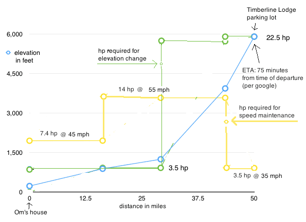

I've got a couple in mind; maybe we should calculate what is required to drive out of Yosemite, for example?

How long do these up-hill climbs last? I have very little experience with mountain driving. I was debating if this thread should go into the "Electrical" sub-forum or the "Mechanical" sub-forum. Now maybe it belongs in the "Earth" sub-forum! :wink:
In my below case, 75 minutes.
Coastal trips vary, depending on who I intend on visiting. (family, friend, foe)
Fun mathematical project. :smile:
ps. I've only lived in upper Illinois once, about 40 years ago, for about 2 months. I never realized your state was so, um, flat.
I have trees in my backyard that are taller than your state's highest prominence: 95 feet?. [ref]
pps. I wonder if roller skates were invented in Illinois?
ppps. Good Lord, you live in a flat state.

Thanks, good example. But it still seems pretty tame for my hypothetical 25 HP hybrid. Dividing it up into a section for each change in required HP, you go for:
~ 16 miles @ 10.9 HP, then
~ 13 miles @ 17.5 HP ...
A 25 HP engine could be supplying this to the wheels, and topping off the batteries as well, if you didn't leave with a full charge. Then you hit the challenge:
~ 14 miles @ 35.5 HP, then
~ 7 miles @ 26.0 HP ...
But getting 10.5 HP from the motors to assist the engine for 14 miles shouldn't be a problem. The Chevy Volt should be able to drive the motors at ~ 25 HP for ~ 50 miles. Then just a small amount of electric motor boost for the last 7 miles.
And in "mountain mode' (attempt to keep the batteries at full charge), there is enough excess HP in the first segments to provide charge for the last 2 segments. An average excess of ~ 11HP for the first 29 miles would offset the draw required at the end. You wouldn't even deplete the battery on that run, you could end up charged higher than you started. But any sudden acceleration like passing would eat some up kWh from the batteries, and probably not recovered by any regen. But still seems like margin under a tough scenario.
Do those estimates seem ballpark correct?
They seem reasonable.
But I'm still wondering what the purpose of this thread is, and what is your ultimate question.
Is it; "Why is the ICE motor 4 times bigger than it needs to be?"?
If that is your question, then I would look at lifespans for motors that run at maximum rated capacity: Outboards. (Also airplanes, but I don't know anything about airplanes. I only know about cars and boats.)
They have lifespans measured in hours. Interpolating the "general internet consensus" on their lifespans, along with how fast my outboard used to push my boat, I come up with a lifespan of 38,000 miles. Not many people would buy cars if they had to replace or overhaul their engines every two years. You are correct, that most cars on the road are barely idling compared to their potential, but that's why some of them last 300,000 miles before they need their first overhaul.
Boats can get away with it, as they are generally used infrequently enough to last for decades.
My outboard motor is as 57 years old, and were I to get around to fixing the spark problem, I'm sure it would last many more years.

russ_watters said:
Ever drive a mountain highway? What does a Volt do if you need a steady 100 kW for 20 min?
Yes I have a volt and have driven in winter through mountains in Canada. In mountain mode the generator will try and maintain 50% charge on the batteries. When it is not able to the power is reduced. So long and short if you can't produce enough you will struggle to maintain 60mph. Hope this helps. Also the car has three modes. Standard, sport and mountain. Sport gives you all the power the car can give from the start(example take off from a stop light.) normal mode has a bit of a lag but enough performance for me (increases your range.) mountain mode sucks the fuel but you will always have a charge. (engine will run constantly until you reach 50% charge or at least that is what I noticed.)
