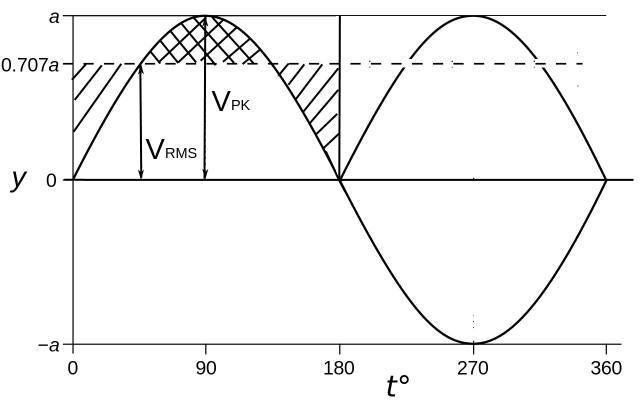

In fact, ##\displaystyle \ \left(V_0\sin(\omega t) \right)^2=\frac{V_0^2}{2}\left( 1-\cos(2\omega t) \right)\ .##
The mean value for that (over integer multiples of the period) is simply (V02)/2 .
Okay, thanks. So, basically, we use the rms values because it just so happens that the energy of the waveform is the same as the energy of a waveform of a DC current with Voltage equal to Vrms?
That's the idea. Specifically:
For DC, the power is given by ##\displaystyle \ P=V\cdot I=\frac{V^2}{R}=I^2R\ . ##
For a sinusoidal wave form, the average power is given by similar relations if you use the RMS values.
##\displaystyle \ P=V_\text{rms}\cdot I_\text{rms}=\frac{(V_\text{rms})^2}{R}=(I_\text{rms})^2R\ ##​
The integral of a curve gives you the area under a curve.
If you plot three curves.. V, the absolute value of V, and Vrms you can see visually that Vrms is the area under the curve. The shaded areas are the same..
