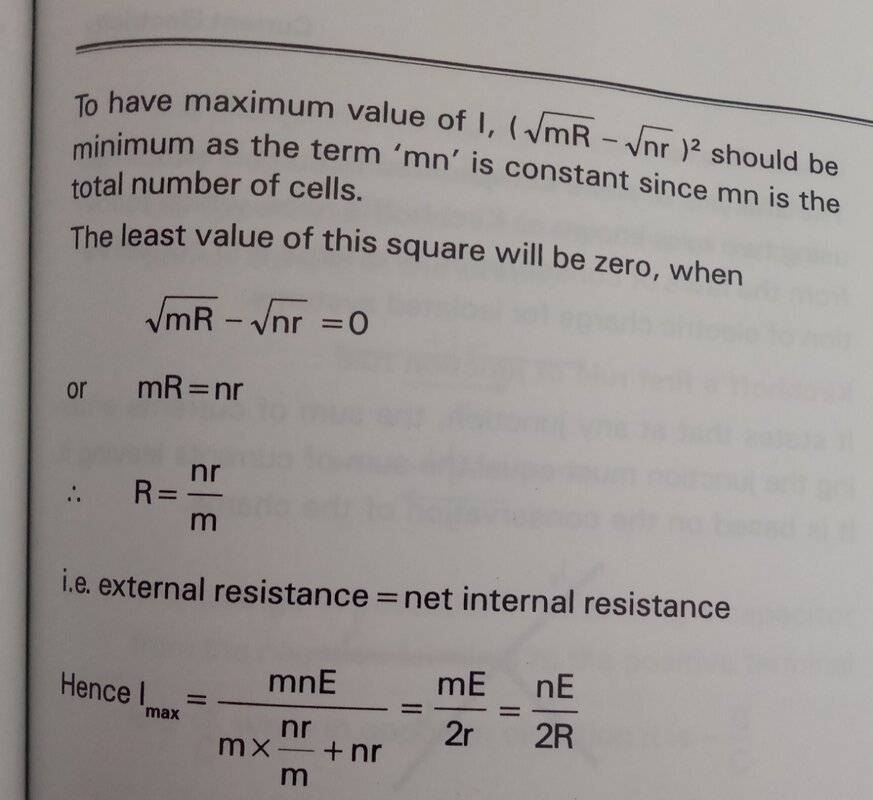

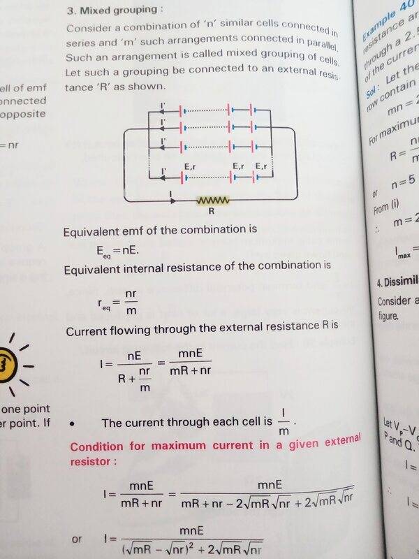

I was trying to understand this,
Page-I
Page-II
It feels that I have done something stupendous in writing the proof,
I just thought that for a single battery the case is same as for multiple batteries but from posts it seems to me that I have done something wrong in converting all batteries into one single battery.

I don't follow their reasoning. The condition for maximum current through the external resistor is certainly still ##R = 0##, for any combination of ##m## and ##n##. Specifically, I think their mistake is taking the term ##2\sqrt{mRnr}## as constant... given that it definitely still depends on ##R##!
It should just be a case of saying that ##R + r## is minimised with ##R=0## for fixed ##r##, and not bothering with whatever they're doing with those square roots!

As I read the text, R is not a variable. We are not optimizing for current as a function of external resistance R. We are optimizing for current as a function of the available parameters, m and n while holding:
R fixed
r fixed
m*n fixed
To put that in a physical context, we have a load device. And we have a shoe box full of C cells. We want to connect the cells in a rectangular matrix to maximize the current we can pump through this device. We do not control the load device (R is fixed). We do not control the nature of the C cells (r is fixed). And the number of cells in the box is also a limitation (m*n fixed).

They will get ##R = \frac{n^2 r}{C} \implies n = \frac{\sqrt{RC}}{\sqrt{r}}## which means$$I_{max} = \frac{E \sqrt{RC}}{2R \sqrt{r}} = \frac{E\sqrt{C}}{2\sqrt{Rr}}$$in terms of those fixed parameters

@Hemant Perhaps you should look at your notes again - or better still, any textbook you are using. The Maximum Power Theorem is something we all go through and, even in an arm waving sense, it's pretty easy to accept and understand. This "Maximum Current' looks like a Typo because (and I think you understand it now) it's highest when the total resistance in the circuit is zero. Maximum Power ( VI ) into the load is when R (a variable quantity) = r ( a fixed quantity) and that's very simple book work.
If you have 'actual hard copy' of the teacher's apparent statement then challenge the teacher with the Maximum Power Theorem. Otherwise you can put it down to a typo on the board or into your notes. All part of the learning process.

Let me go through their derivation slowly and see if I can make sense of it. I think slow, so bear with me.
They are trying to get an equivalent circuit out of this. They compute the EMF of the equivalent circuit:$$E_{\text{eq}}=nE$$Here n is clearly the number of cells in series in the matrix. They go on to compute the equivalent resistance:$$r_{\text{eq}}=\frac{nr}{m}$$Here m is clearly the number of rows in parallel. So far, so good. Trivial stuff.
Now we compute the current being pumped through the load. This is EMF divided by total resistance:$$I=\frac{nE}{R+\frac{nr}{m}} = \frac{mnE}{mR+nr}$$This is just substituting the equivalent values for the battery matrix into I=E/R and then simplifying a bit.
The next bit is where they exercise a bit of foresight. They are trying to set up to rewrite the denominator as a sum of squares. So they add zero, cleverly written as ##-2\sqrt{mR}\sqrt{nr} + 2 \sqrt{mR}\sqrt{nr}## to the denominator. This let's them then regroup and rewrite the denominator as ##(\sqrt{mR} - \sqrt{nr})^2 + 2\sqrt{mR}\sqrt{nr}##. That was the hard part. It is all downhill from there.
What we have at this point is:$$I=\frac{mnE}{(\sqrt{mR} - \sqrt{nr})^2 + 2\sqrt{mR}\sqrt{nr}}$$We are trying to maximize this.
The numerator is fixed. The denominator is positive. So we are trying to minimize the denominator:$$(\sqrt{mR} - \sqrt{nr})^2 + 2\sqrt{mR}\sqrt{nr}$$The right hand term is fixed. So we are trying to minimize the left hand term:$$(\sqrt{mR} - \sqrt{nr})^2$$That reduces to trying to make ##mR## as close to ##nr## as can be arranged.
And we are basically done.
Likes Frigus, DaveE and etotheipi

Thanks for writing this long post and rectifying most of my confusions,the only confusion left was that if ##r## and ##R## are constant then why ##R## depends on r as ##R##=##\frac {mr}{n}## and now this problem is also cleared as it was stated in your post that it is internal resistance of a single battery that is constant not the equivalent internal resistance.

total resistance:I=nER+nrm=mnEmR+nRThis is just substituting the equivalent values for the battery matrix into I=E/R and then simplifying a bit.
Their is a small problem in this equation,
In denominator their should be ##mR+nr## but not ##mR+nR##

I talked about this to my teacher again and he told me that it is not current that is maximum but power,the problem was that it was me who wanted to listen maximum current and that's why whole confusion is created😐.
