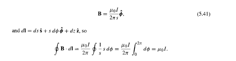

I want to calculate the line integral of ##B## around the circular path of radius ##s##
I know the solution:
But I have been thinking on how could we prove that it does not have to be circle. The line integral over the closed path should always yield the perimeter of a circle for the answer not to change. However, this seems contradictory; I actually want to proof that it does not depend on the path.
What am I missing here?
Thanks

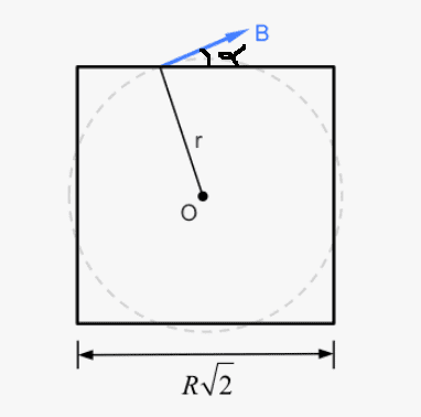

kuruman said:
You can test this theoretically by yourself. Consider the usual circle of radius ##R## with a current-carrying current ##I## at its center. Now consider a square Amperian loop of side ##R\sqrt{2}~##inscribed in the circle. Calculate ##\oint \vec B\cdot d\vec l## around the square loop and show that it is equal to ##\mu_0~I##. Hint: Exploit the symmetry of the problem. You only need to find ##\int \vec B\cdot d\vec l## along one side of the square and multiply the result by 4.

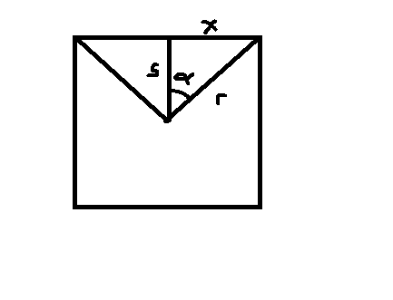

Let's focus on getting the magnetic field due to one of the four edges, which is a straight wire.
Such a magnetic field is:
$$B = \frac{\mu I}{4\pi R'}(sin \theta_2 - sin \theta_1)$$
Where
$$R' = \frac{R\sqrt{2}}{2}$$
This yields:
$$B = \frac{\mu I}{2\pi R}$$
The magnetic field due to the entire square is:
$$B = \frac{2\mu I}{\pi R}$$
But I should get ##\mu I##. I must be missing something...

JD_PM said:
But I should get μI\mu I. I must be missing something...
You are missing that you you are not looking for the "magnetic field due to the entire square". You need to do the line integral ##\oint \vec B \cdot d\vec l## around the square knowing that ##\vec B = \frac{\mu_0~I}{2\pi r}\hat {\theta}##. Note that along the side of the square ##\vec B## varies both in magnitude and direction.
  • #35
But isn't ##B = \frac{\mu I}{4\pi R'}(sin \theta_2 - sin \theta_1)##? If I am not mistaken, ##\vec B = \frac{\mu_0~I}{2\pi r}\hat {\theta}## is the magnetic field due to an infinite straight wire (which is not the case here; we're dealing with a finite straight wire).
To calculate ##\oint \vec B \cdot d\vec l## I'd tend to do the following:
$$B = \oint \vec B \cdot d\vec l = \oint \frac{\mu I}{4\pi R'}(sin \theta_2 - sin \theta_1)\cdot d\vec l = \frac{\mu I}{2}(sin \theta_2 - sin \theta_1)$$
Is this what you were asking for (this is just for one edge of the square)?
I'd say that ##\oint d\ell## is still a circular loop; the square's case with field's point in the center of the square is like four times straight wire's case with field's point above the middle point of the straight line.
