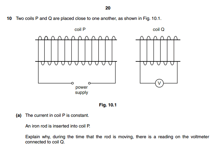

Why there's a reading on the voltmeter connected to coil Q?
In summary, when an iron rod is inserted into coil P, it magnetizes and creates a change of flux in coil Q. This causes a change in the magnetic field, which is described by the equation B=uIn. The current in coil P is changing due to the change in flux, while the number of turns in coil Q remains constant. The relative permeability u is a constant that describes the material's ability to be magnetized. The reading on the voltmeter connected to coil Q is a result of this change in flux, not due to "screening" of magnetic lines.

The current in coil P is constant. An iron rod is inserted into coil P. Coil Q is placed next to P with a voltmeter connected to it. Explain why, during the time that the rod is moving, there is a reading on the voltmeter connected to coil Q
emf=-Dphi/dt
[/B]
I believe that the Iron rod will first be magnetised and then the magnetic lines originating from Iron will cause a change of flux in coil Q.
Find the equation for the magnetic field produced by a coil/solenoid. What does it depend on? What is changing in this set up?
The equation is B=uIn, and none of the u and n are constant. Current is changing due to change of flux inside the coil P as Iron screens the magnetic lines of P?
The number of turns n is constant, as is the length l.
What do you know about the relative permeability u?
PS it's nothing to do with "screening".
Nope.
Reconsider post 2. Diligently.
