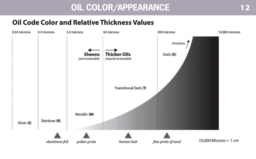

A method used to estimate the volume of an oil spill on water is to measure the area of the spill and use thin film interference to figure out the average thickness.
Likes etotheipi
That's a nice application, it's good to know theory is being put to good use! I wonder how accurately they can judge the colours. It looks like the pretty rainbow thin film interference is limited to very thin oil slicks...
