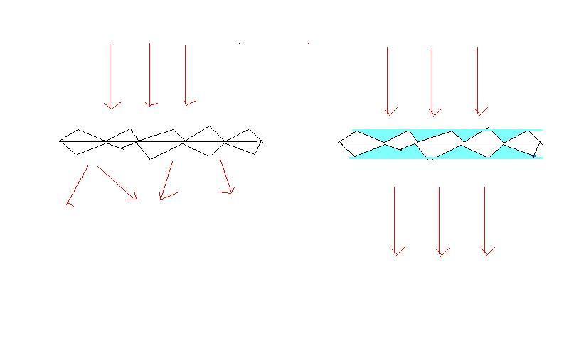

What the scientific explanation of the phenomenon that when you put water on white matirials such as paper or cloth they become partially transparent?
The transparency of white materials when in contact with water is due to the difference in refractive index between air and water. White materials, such as paper or cloth, are made up of fibers or particles that have a different refractive index than air. When water is introduced, it fills the gaps between these fibers or particles, matching their refractive index and allowing light to pass through.
The presence of water changes the refractive index of white materials, which in turn changes their optical properties. The change in refractive index allows light to pass through the material, making it transparent. Additionally, the water may also cause light to scatter differently through the material, changing its appearance or color.
No, the transparency of white materials in contact with water is usually temporary. As the water evaporates, the fibers or particles in the material return to their original state, with a different refractive index than water. This causes the material to become opaque again.
Yes, the transparency of white materials in contact with water can be reversed by removing the water. This can be done through methods such as drying the material or using a substance, such as alcohol, to replace the water in the gaps between fibers or particles.
Yes, besides water, other substances with a similar refractive index to the material's fibers or particles can also cause transparency. For example, oils or solvents can have a similar effect as water, filling the gaps between fibers or particles and allowing light to pass through.
