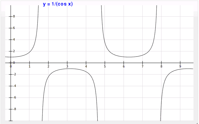

Hey all,
"In AM synchronous demodulation, Why we don't divide m(t)coswt by cos(wt)
instead of multiplying by cos(wt), since this can be easily implemented by a simple divider circuit?"
If it's all about thinking mathematically, then it seems like it's more intuitive and a whole lot easier if we just divide by coswt, why we go through all the trouble and multiply then we have to know the trig identity of (cos(a)cos(b)) and then put a LPF after the output...
I asked this question to two professors and I got different answers:
#Professor 1 Reply:
"For your scheme to work you must know exactly what the frequency w is that the transmitter is using, which tends to drift. So try your scheme with dividing by cos (w+delta)t and see whether you can recover the signal." #Professor 2 reply was:
"we don't use the division scheme for two reasons:
a- In the real world, noise is added to the received signal and it is going to look like this, m(t)coswt+n(t). If you then divide by coswt, you will get, m(t)+n(t)/coswt, and since the cosine function ranges from -1 to 1, thus for values of cosine less than 1, the noise term will increase much more, so you will get poor SNR.
b- When the cosine function goes to zero, you will divide by zero and this will cause amplitude spikes which leads to circuit saturation."
I am now confused more than ever:confused:. which one is true?
I like the sound of that. Very difficult to argue around it.

I think the question has been answered several times but perhaps not in direct enough words.Professor 2 is certainly right.
Since cos(anything) is never greater than 1, niether is ((cos(anything))^2. With multiplication, as input gets smaller so does output.
So a multiplier will never be asked to deliver a large result because its gain is always less than 1.
But a divider must be capable of quite high gain, hence it is capable of producing quite large numbers.I have built analog dividers. To keep them stable with small denominators is well nigh impossible.
When designing any machine why would you intentionally make it inherently unstable?

Imagine the 1/cos function. Those spikes are terrible! And you multiply your function with it. If there is any signal at all there due to white or whatever noise, it will produce a giant signal. So you will see the same spikes again after dividing your signal. These spikes have twice the period of your carrier so they will be full of harmonics of the carrier frequency.
And finally we have the answer why this stuff isn't done. Three things will kill the scheme:
1) Noise. If your signal is f(t)cos(kt)+e(t) where e is noise, you will have divergences in the spikes of the 1/cos function, because e(t) is surely not zero at the crossings. As I said: you amplify your signal infinitely in the region with the worst signal to noise ratio.
2) Phase and frequency. If your local oscillator is not perfectly phase and frequency locked against the sending oscillator, the zero crossings will be off, the spikes will not get canceled and will dominate whatever comes out
3) Offset voltages. It is pretty much impossible to have components without any offset voltage. So even if your frequency and phase would match perfectly, your zero crossings will be off again producing spikes.
Infinite spikes are simply a bad idea. This type of problem happens also in the Wiener deconvolution, where you also divide the blurring of the signal away, but due to the same signal to noise problems you need to dampen the method at the frequencies were the noise is large compared to the signal.
  • #34
0xDEADBEEF said:
You substitute the multiplication with cos(x) by a multiplication with 1/cos(x).
That is a very clear-eyed way of expressing it.
Multiplying by cos x looks much smoother than multiplying by this:
