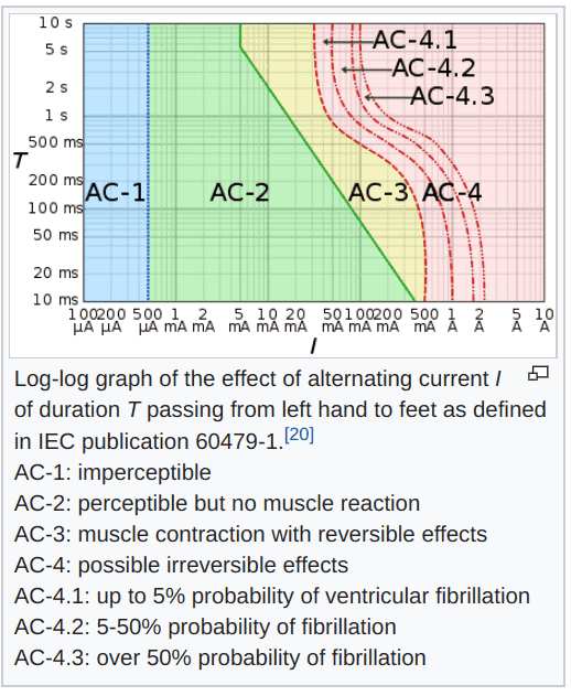

It's more complicated than just voltage.
You should read this
https://en.wikipedia.org/wiki/Electrical_injury
In addition to voltage it depends on skin and body resistance, and point of entry and several other factors.
Likely the highest voltage we may ever experience is the static shock that we might get after walking across a carpet in winter. I used to get static sparks from the door handle on my car in winter. Electrostatic shocks can be as much as 10 or 20 KV. They can be dangerous to certain people, but usually not.

...I acknowledge that it’s hard to encapsulate a complex subject in one sentence. The thing that kills you is energy, E=VIT... In mains power situations, there is essentially limitless energy available, so mains safety focuses on current. I think that’s where the confusion lies.
For example, a VdG generator shock will deliver a very large current through you, but it decays so quickly that an insignificant amount of energy is transferred. Defibrillator shocks are dispensed in joules, too.
But there still has to be a time limit for the energy transfer, right? Like, it has to be delivered in a certain fraction of a heart beat?
For reference, google gives me common defibrillator shocks in the range of a few hundred Joules. A mid-sized residential air conditioner (3 Ton) pulls about 4,000 J/s, and the circuit would be capable of much more for a short time before the circuit breaker blows.
Look at the curves in post #2.
Likes sysprog, russ_watters and Guineafowl
Yes, as per the curves in the graph above. As I say, it’s hard to encapsulate this complex subject in one sentence, but at least E=VIT gives a better understanding than ‘it’s not the volts, it’s the amps’.
